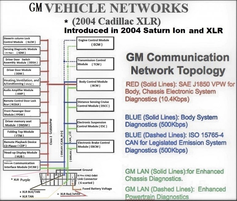

Attached is a breakdown of the Saturn Ion electrical, the same as the XLR.
That schema indicate the systems and with witch modems that they do communicate.
The Saturn wiring colors circuits are of some different colors for the XLR, at the lower of the page the proper colors are indicated.
Knowing now that the Saturn use the same electrical systems that is a good news, as the Saturn repair shop could be able to repair the XLR, as we know that most of our problems are electrical.
Enjoy the viewing and get familiar with the schema.
