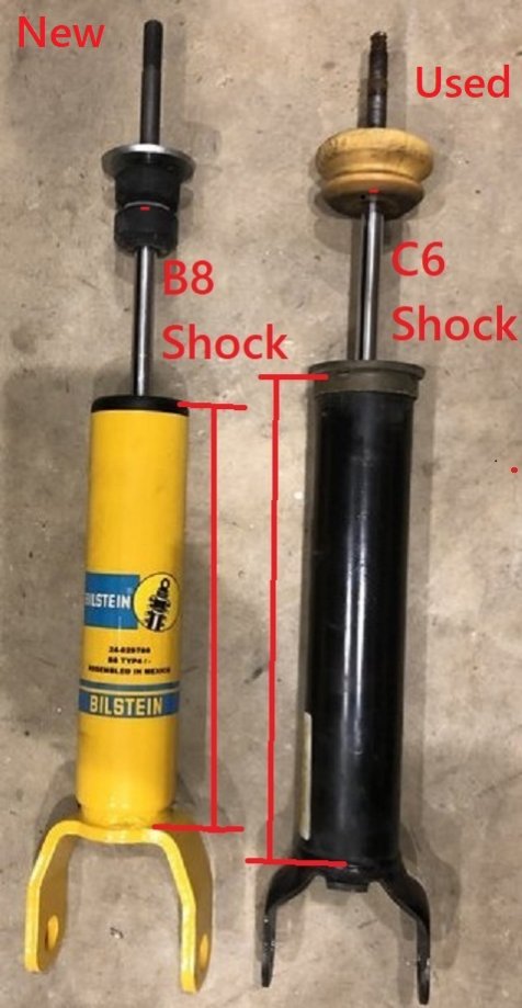

Enclosed is a photo that shows a B8 Bilstein shock and a C6 GM shock, as you can appreciate the B8 is shorter and it is accordingly to the advertising that Bilstein is saying.
The b8 shock is made to fit also the regular XLR suspension spring or of a stiffer and lower sport suspension, of the c6 Corvette.
To get the shocks to fit properly with the XLR spring, the adjustments bolts has to be properly done, in line with the attachements of the shorter B8 shock.
For an XLR, that means it will lowered the car body down, like many members want it…. also the car could hit their driveway, that, they dont want this to happen…. that is for sure.
This is the reason I would go for the GM c6 fe1 shocks, knowing that the Bilstein product is far better, however the GM shock will still keep the soft drive of my XLR that
meets my style of driving.

First, this C6 used shock stem is lower because its oil or gas were lost, also its inside pressure..... usely the stem is much higher then the New B8, that means the Bilstein shock is still a lot shorter. ( Also the used shocks lay lower and the top bushing is already higher)
As Hans said the rear spring has to be adjusted in order to make it fit in line with the (shorter) new B8 shocks, and doing it so this adjustment, it will obviously create a lower ride, because it is a shorter shock.
This is what I have said from the beganning on this issue and I stand on my opinion.
For sure the B8 is not my choice, may be the B6, but its length would be in first place, very close checked.

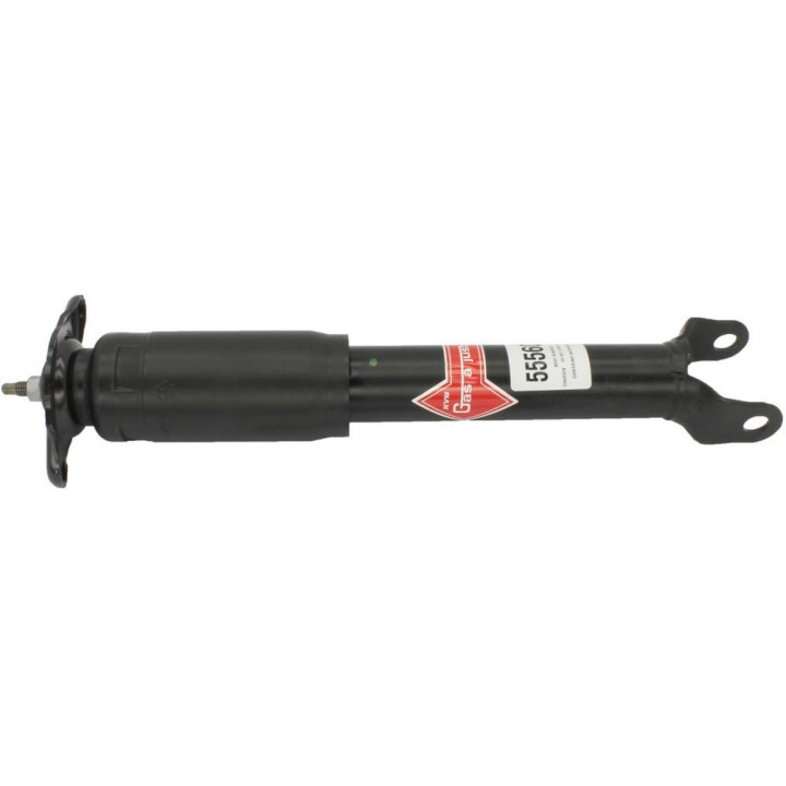

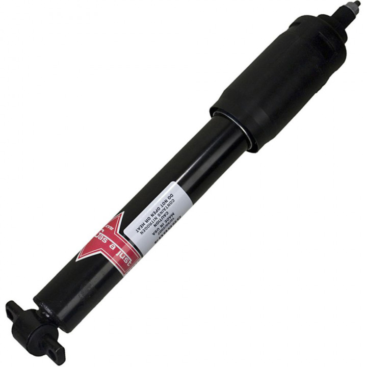

Here are the KYB gas mono tube shocks assembly and their part number 555 604 front and 555 609 rear.
