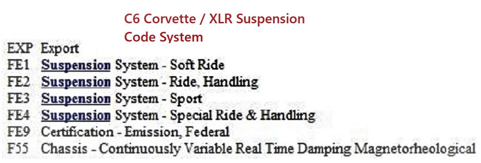

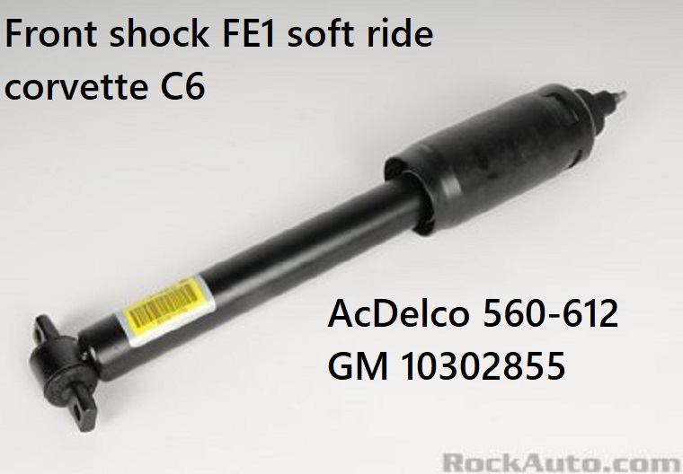

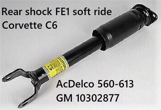

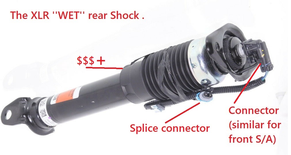

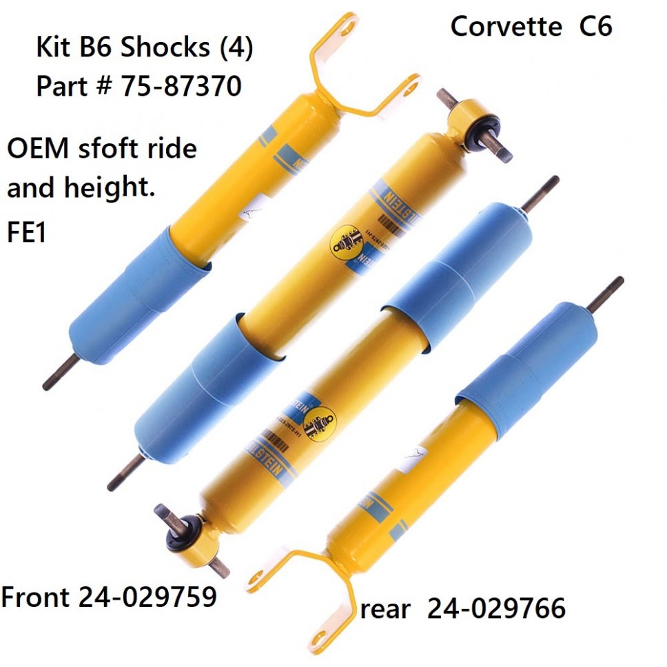

just buy the stock z06 Corvette shocks. you can get a set of take offs with no miles on them on ebay for 400$ and the sims for 200 .Add a sway bar for 125 and your ride will be as good to better than it ever was when new. I just road in a car with brand new Mags on it and it did not ride a bit better that I could tell. Mine with the sway bar was much flatter on the exit ramp and did not sway when changing lanes fast. Your suspension module has to be working to use the non mag shocks. I now have a work around for bad modules that will turn the dash light off.
![s-l1600[1].jpg s-l1600[1].jpg](https://www.xlr-net.com/forums/data/attachments/5/5088-a06beea2ce48be23e018b6427dec4236.jpg?hash=oGvuos5Ivi)
![75-87370_b7-1[1].jpg 75-87370_b7-1[1].jpg](https://www.xlr-net.com/forums/data/attachments/5/5227-dd6c3a3b9d25357a57a9aaf4be9e51fc.jpg?hash=3Ww6O50lNX)
![560-612_Primary__ra_p[1].jpg 560-612_Primary__ra_p[1].jpg](https://www.xlr-net.com/forums/data/attachments/5/5228-de12d5a520428456f94a82d21c0c10dd.jpg?hash=3hLVpSBChF)
![s-l1600[3] (2).jpg s-l1600[3] (2).jpg](https://www.xlr-net.com/forums/data/attachments/5/5229-c513aa5a70177722d3c460cd93a7a8a5.jpg?hash=xROqWnAXdy)

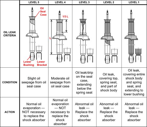

![0A1    front-shock-replacement-guide[1].jpg 0A1    front-shock-replacement-guide[1].jpg](https://www.xlr-net.com/forums/data/attachments/5/5242-b9e9c46e4f3dd78bb6232fc4d4c8e60b.jpg?hash=uenEbk8914)
