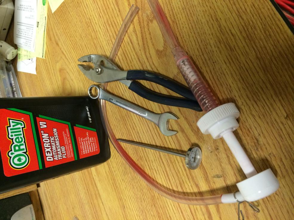

I got around to checking the trans fluid level today. It was 5-6 oz low from the rad replacement. The vehicle needs to be level, so without access to a lift, I used 4 jackstands. This is not the safest thing to do, you must be very careful when positioning the stands, and careful not to rock the car when starting or wrenching. Be sure you are on a level surface. A well positioned ditch could be an alternative.
A fluid pump is necessary to add fluid, as there is no space to position a bottle above the fill plug (which is a rubber grommet with center pin). The thermometer probe I use for checking the HVAC temps was just long enough to reach the fluid through the fill hole. The trans fluid needs to be 86-122 degrees to get the right level. It took about 45 min for the trans to cool to 120 after steady driving. The level check bolt (shown in earlier post) is a 14 mm. Fluid will drip out once the right level is reached, so have a pan ready. Before adding fluid (recall this is a level check, not drain and fill, otherwise you would want at least some fluid in the trans before running), the car needs to be running, and you need to cycle through each shift position for 3 secs each, then return to park.
The tools for this check are pictured below (14 mm wrench, pliers to pull grommet plug, temp probe, dex vi fluid, fluid pump). As usual for this car, much more difficult than necessary, but not all that bad.

Thanks for posting the transmission info in detail. Your efforts to document this and the radiator replacement are really appreciated. I want to change the fluid and filter in my 2006 V with about 75,000 miles on it. Looks easier than the 5L50 in my 2005 STS. On that one the excess fluid drips out on to the hot exhaust pipe which will also burn you in the process of trying to reinstall the plug. Fortunately I do have a lift which will make it a lot easier than crawling under the car. The lift was a must have when I turned 60 years old!
I just noticed that you are in Houston. You are welcome to come up and use my lift anytime, beats putting your car up on jackstands and a lot safer too. Also have a Tech 2 which makes reading the trans temp a lot easier.
Thanks onalaska! I may take you up on that someday, though I live all the way down in the city by Memorial Park, so its still quite a hike up to Coldspring.

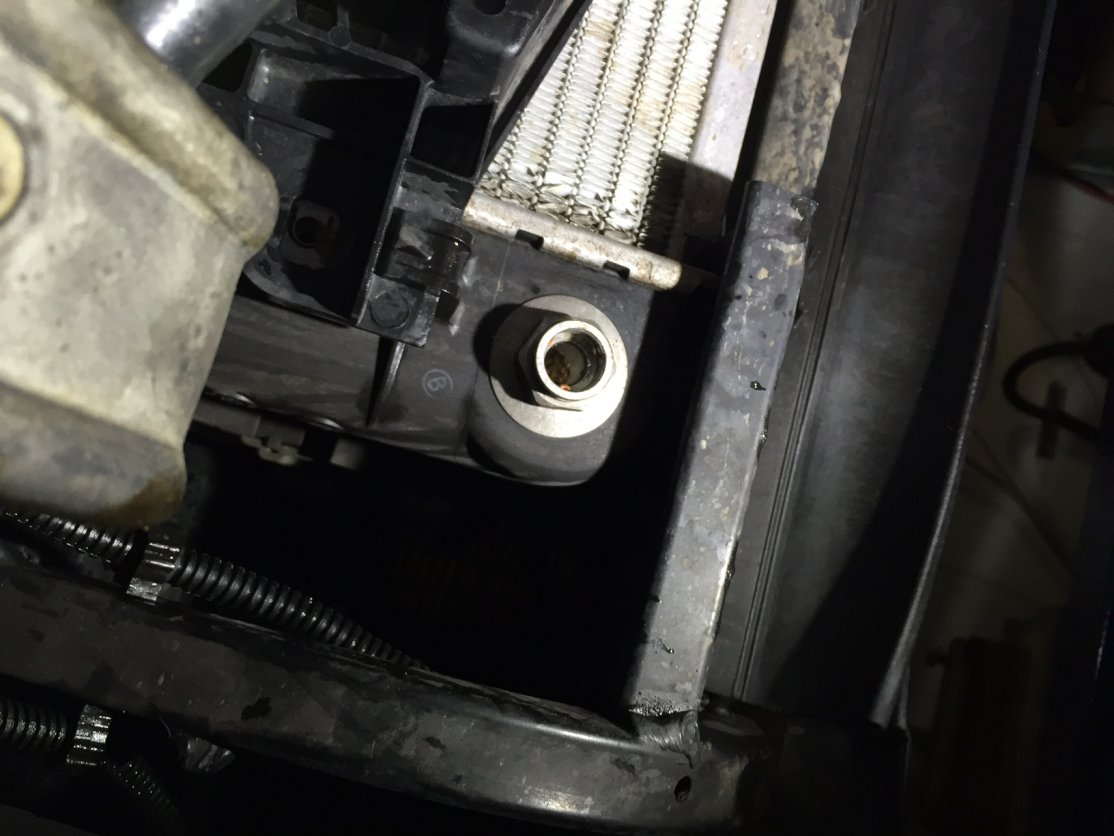

I have a really crazy question, I have recently developed a serious coolant leak and after looking for the source I found this open fitting on the drivers side of the radiator. There are no tubes attached to it nor the upper one. Is this tank for the V version of this car? I have a 2004 normally aspirated engine, I seemed to remember that the previous owner had the radiator replaced could it be that my engine didn't use this part of the radiator and now the core is compromised and leaking into this area? Am I looking at needing a new radiator? I don't see any lines in the vicinity of these fittings that may have popped off. See photo below.

What you are seeing is I believed the engine oil cooler. Your 04 did not have this. If you do not see antifreeze leaking out or around those fitting that's not your problem. When the previous owner replaced the radiator he used the V version radiator. You need to pressurize the system to find where your leak is .

Ok that makes sense I just wanted to make sure. Thanks for the response. I borrowed a pressure kit from a local autoparts store but I don't think it's going to work since the purge port of the over flow tank is not sealed. Have you pressurized this system before? Any hints?
