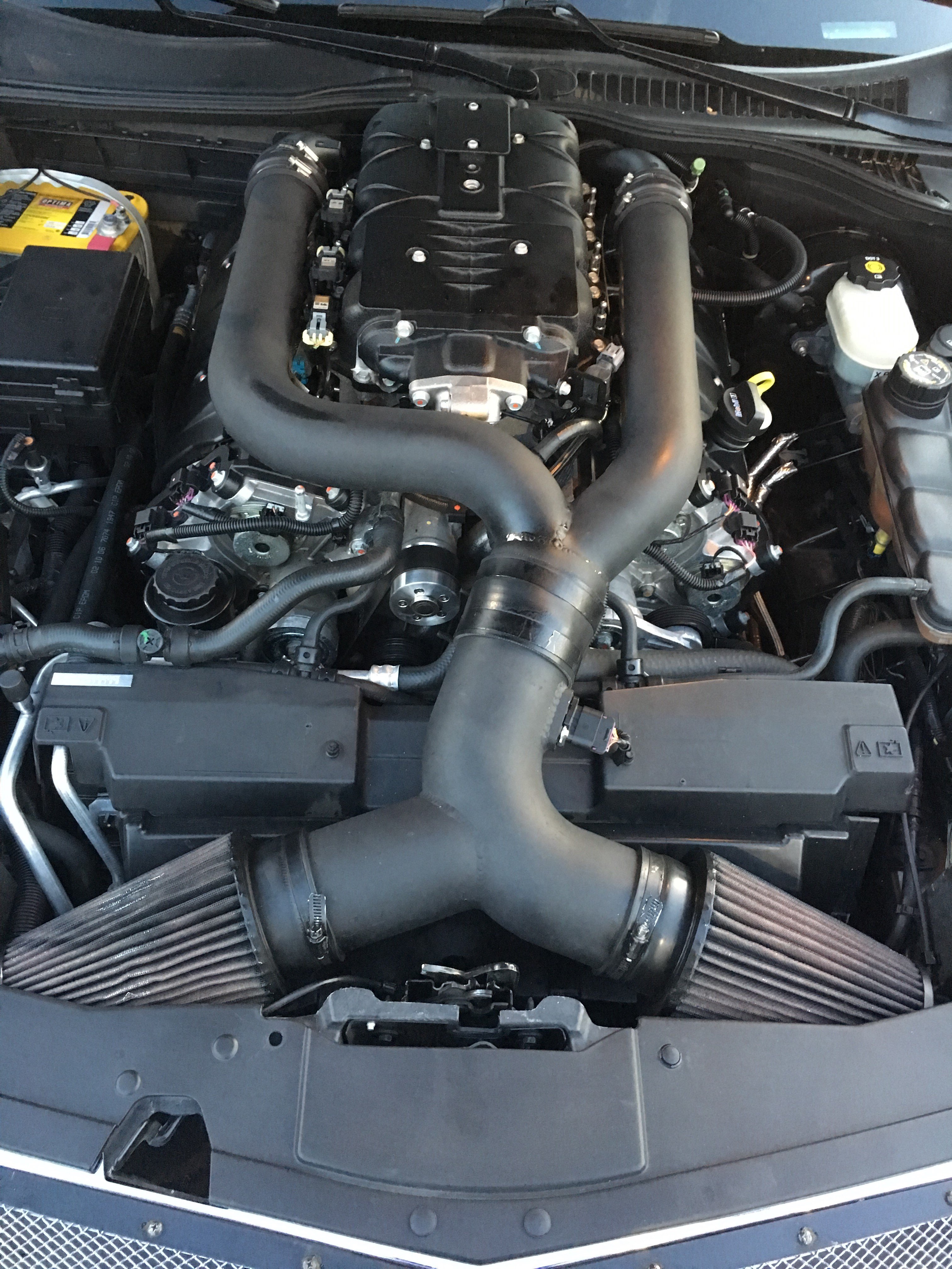

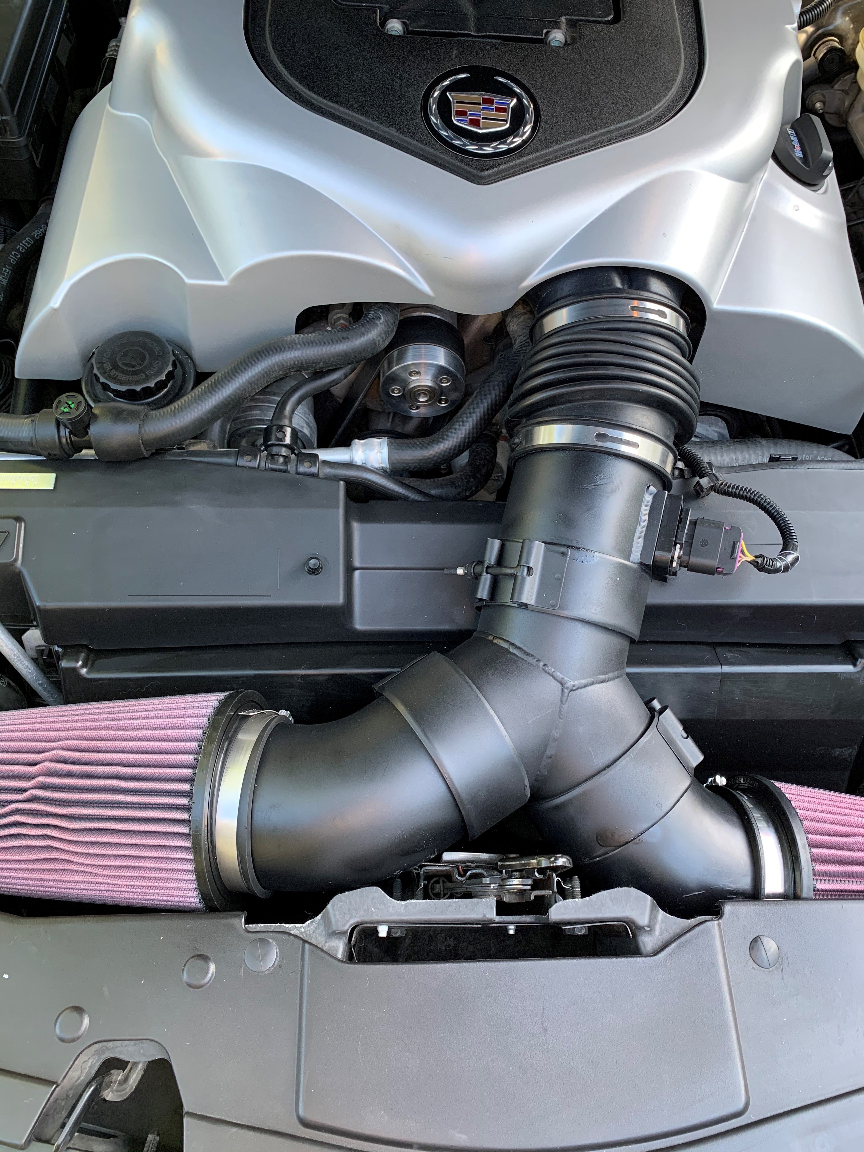

well i have tuned all 3 of the v's that i've had...2.55 in snout pulley ...i used the air intake in the photo... they don't make them any more. i forget the name..so had to just put the y pipe and filters...photo
i have spent 10 of thousands of dollars on exhaust over the years .corsa, SLP, Borla, Flowmaster all of them..but you know what? i never like any of them, .now i only do muffler delete...keep the cats and resonator and run just a straight pipe and it sounds amazing...
i have tommy wong at wongs performance in Vancouver WA tune the car he is the best around for GM tunes in my area ..it scary fast lots of power think it was 435 wheel

Well i doubt many of the members here would do a muffler delete. I wondered why d3 did a power steering pulley replacement instead of a snout pulley replacement which is much easier and cheaper. The chatter was in the rear end. The power steering noise is usually because the gear drive on the pump is stripped.
I honestly don't know why, but I read once that a smaller snout pulley was more prone to slipping and could require machining clearance on the SC itself. That makes an argument for changing a pulley that is a simple swap. You're way-more of an expert than I am, but that is a line I've heard before.

Thats sort of what i heard. this guys hp numbers are closevto what d3 charged close to 10 grand to get. The boost with the snout pulley is very little improvemrnt. And the corvette guys say major slippage . vety lttle area for the belt to grab. i dont know supercharges.ni like turbos. In high school our teacher said exhaust gas wss free to spin turbos but supercharges took engine power to turn them. I think now its pretty even .
