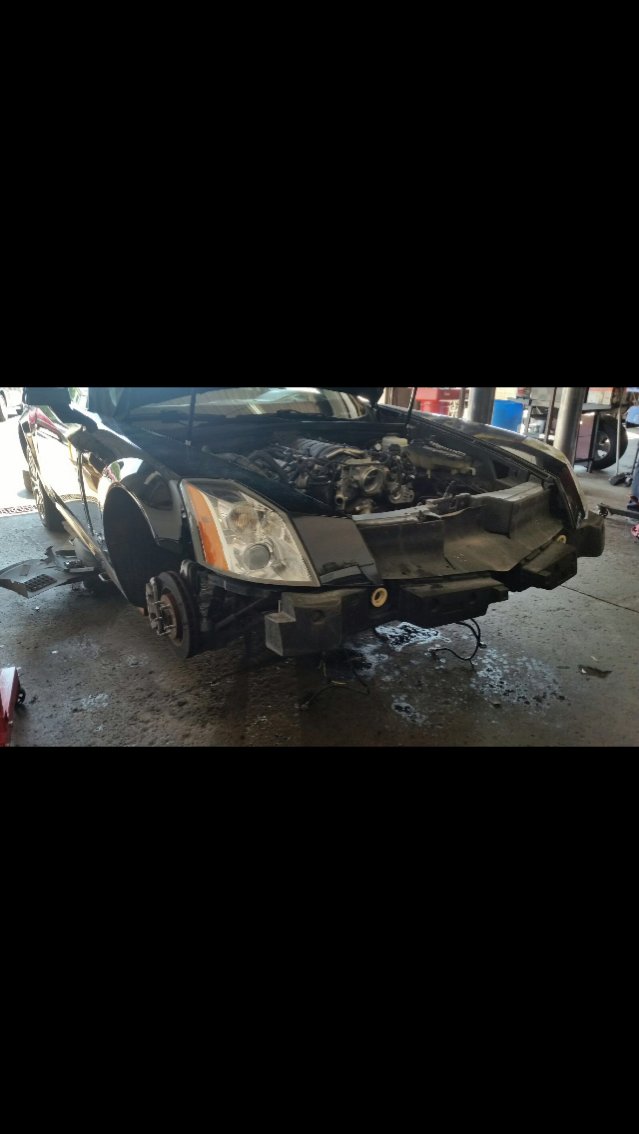

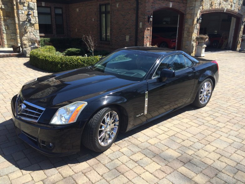

Hi guys, I am an new owner of a 2009 raven black car. I have some other sports cars; but i like that you don't see many xlr's around town.
The northstar was a little tame for me; so it is now a twin turbo ls3 xlr with 750 rwhp.:D:D
here ya go.
Its an awesome sleeper. Not a cheap conversion; but its awesome.:cool:

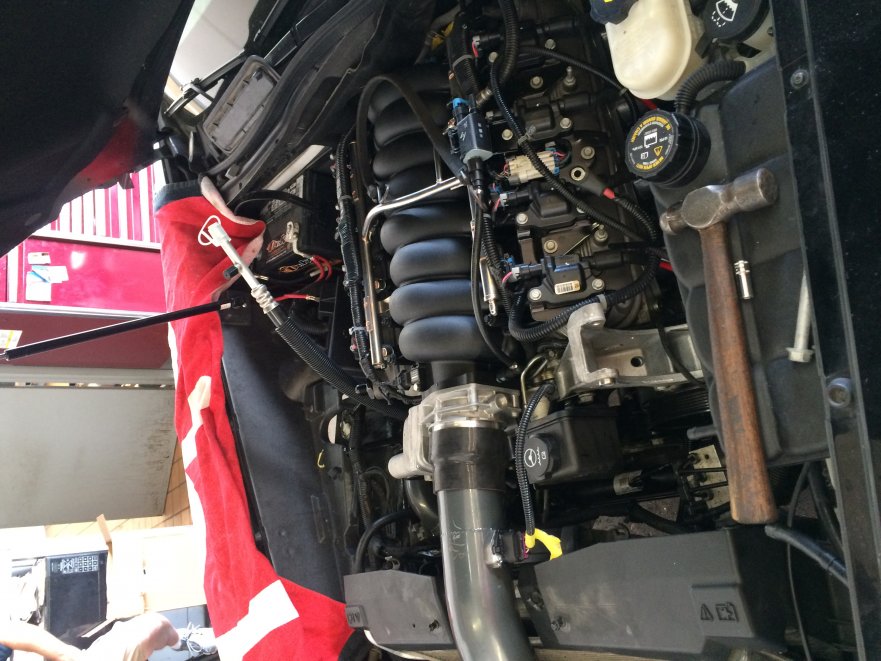

The actual swap took about 40 hrs to complete.
removing northstar
making a custom engine harness
installing ttix c6 corvette turbo kit/ls3 install
The planning started last fall after i removed my forged 416" ls3 to have it freshened up.
I actually took a while to find the appropriate xlr to do the conversion to. Most 2009's were just to expensive. I got a deal on mine because it needed some basic tlc.
It's apparently one of 58 cars made that year.

So the LS3 motor will fit up to the Transmission or did that need to be adapted?
Everything is Bolt in. The LS3 requires the Corvette torque tube however

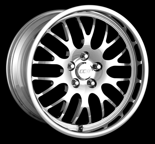

I just completed the motor part of the swap. I did how ever upgrade the brakes to c6 z51 rotors and upgraded the suspenion with 6 z51 sway bars front and rear. I want to see how the car drives after I get my new rims. I believe I can get a 10" wide rim on the back.
I sort of like the way the electronic shocks feel. If its too soft, I can easily change the leaf springs to c6 z51 or zo6.
This wheel is ccw sp20. One pieced forged wheel. I have ccw wheels on my turbo vette. they are high quality!
Also, I think early models would not be suitable due to the 5 speed trans. I think the best cars would be the 6speed cars for trans durability. Actually the non V cars have a looser torque converter which is desired with my turbo car.
