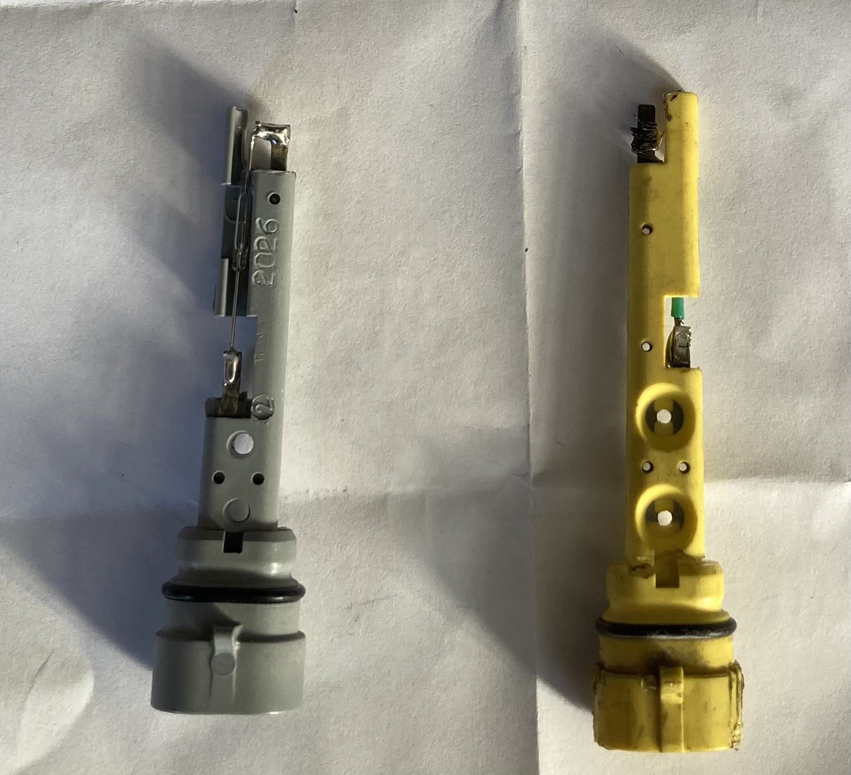

Thanks all for taking the time to comment, looking forward to the interaction. Love the way the car looks and drives, was expecting a little more pep, but the comfort will make up for it. I’m finding out about the lack of parts and support as I go. The only thing I’ve attacked so far is to low coolant level message, no sensor listed, and Rockauto had tanks with sensor included for sale. Got 2 tanks, and neither had a sensor. Sent them back, and jumpered the plug. I have ordered a sensor for a 2013 - 2018 Dodge that looks the same, but in gray. Figured I would give it a try. Thanks again for your time.
Bob
Remember the basic convertible is the Northstar V8 engine package. Nothing like the supercharged "V." Good luck with the sensor swap. As mickeytee would say, update us on how that goes for future work arounds....

Well I received the Dodge coolant level sensor, it was a little shorter than the original. Plug was the same, and it fit perfectly into the tank. Didn’t get rid of the error. Went back to the shorted plug.
