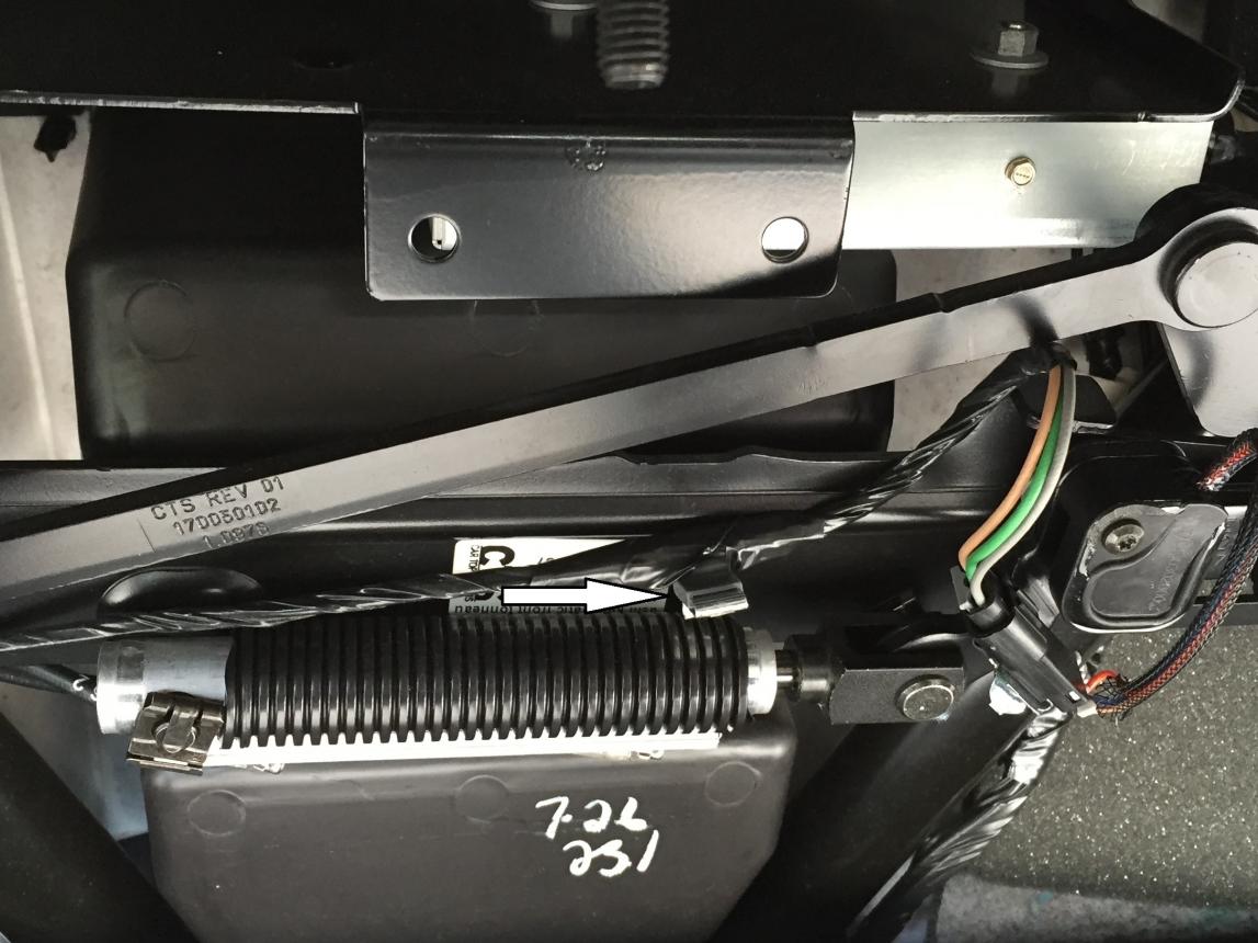

I was replacing the FTPS this morning and found that the switch had been worked on before. The wire to the plug has a clip that was disconnected from some position but I cannot tell where. The repair manual does not show the routing. If someone gets a chance and could snap a picture and post here, it would be a huge help. See attached picture - arrow pointing to loose clip.

It clips to the rib that is right above it in your picture, between the two bumps. Slack in the wire should then be bowed to the back. Just had to replace mine.
Dave :wave:
Thanks
Dave
Thanks for pointing me in the right direction. I did an extensive internet search for some pictures but had no luck. I would still appreciate a picture if you get a chance.
