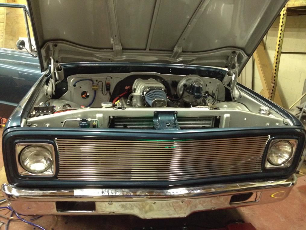

That is awesome! I owned a custom body shop for several yrs, and had the privilege of doing some really awesome builds...but most were for customers. We dropped a 502 RamJet crate motor in a C10 resto-mod...and that was sweet.

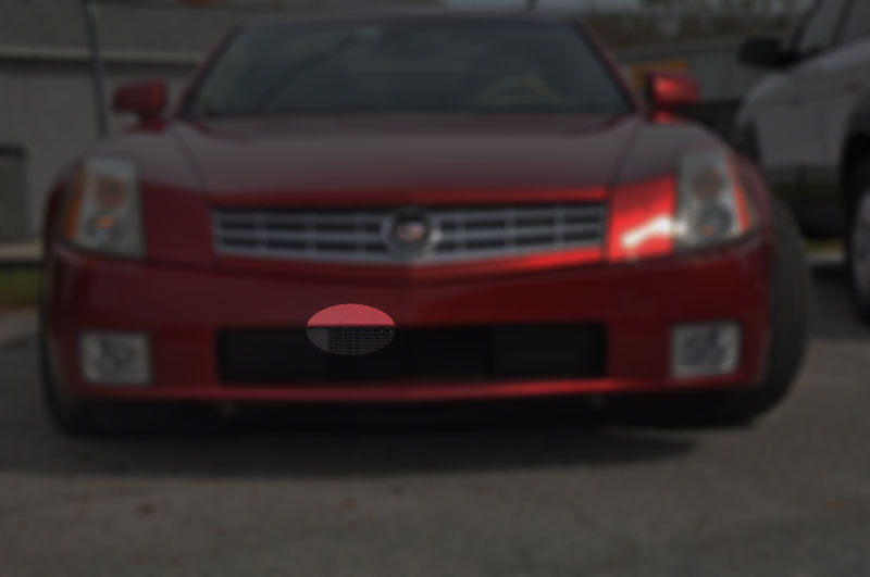

I just completed installing an external hood release & a external 12 v plug using a Perko watertight deck connector. The Whistler jump & go fits perfect on the left side grill panel. If battery goes bad I can do everything from outside the vehicle. No negative comments necessary just info for those Who may have misplaced the key. Would post pics but have not determined how.
