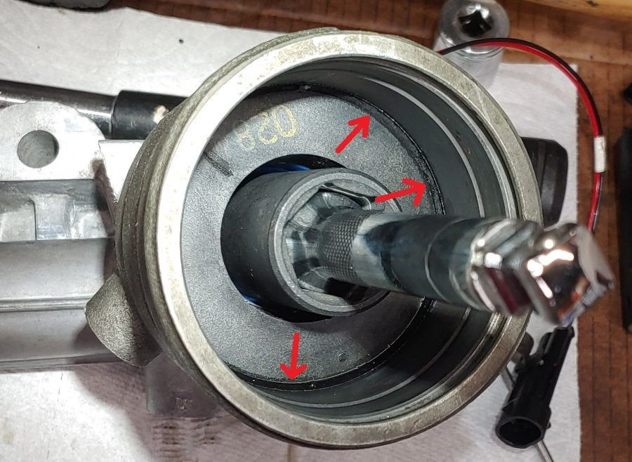

The Variable Effort Steering (VES) system, or MAGNASTEER II is actually epoxied to the inside of the housing so I did not take that out,
However, a CorvetteForum member bradleyss14 shared very helpful information which I will re-share with you: first liberate the Magnasteer actuator, by carefully scraping away the epoxy which holds it in place. This epoxy runs the whole way around the actuator, shown here with red arrows:
Then the Magnasteer actuator can be slid out of the pinion housing (be careful with the wires). Also note that the connector at the end of the wires won’t fit through, so either the connector needs to be de-pinned or the wires cut and then spliced back together later.

So the sealing material around the electric motor (aka VES) is actually an epoxy? A hardening epoxy? Or is it a non-hardening RTV sealant? Or maybe a non-hardening urethane sealant? Unfortunately there's no way tell what it is from a visual exam. Be nice to know what product to use if & when I have to do this.
I guess the next question is how are the wires that penetrate the pinion gear housing sealed? Since you didn't remove the VES I guess you didn't re-seal that area. This is what started leaking on the 1st rebuilt rack installed in my car so I'd like to know how to address this. The 1st rebuilt rack only lasted 4 months before it started leaking from the wires. Perhaps the rebuilder did just like you did and didn't remove the VES at all. He only replaced the seals that he could get replacement parts for. If so I'm not hopeful that the 2nd rebuilt rack will last any longer than the 1st one did.

The comment on the VES unit is important. Since the wiring area leaks it seems that where the wires penetrate the pinion housing that this NEEDs to be addressed during a rebuild. At least it needed to be in the 1st rack I ended up with. If this section is "left alone" during rebuilds it's no wonder the rebuilt racks don't last. Be nice to find a way to address this. Seems like a common failure on all the MagnaSteer racks.
If the VES unit is not serviceable (sealed) then I can understand the hesitation to remove it. But in order to re-seal the wires it looks like it has to be removed in order to access the wire seal in the housing. I'd have to take one apart to find out for sure. Not thrilled about the prospect.

"So the sealing material around the electric motor (aka VES) is actually an epoxy? A hardening epoxy? Or is it a non-hardening RTV sealant?"
It is a hardening epoxy. In one video the DIY guy actually had his mechanic brother dig the epoxy out around the magnet and clean up the wire rubber and make a new place for an O ring. It is shown. Then he epoxied the unit back into the spot. Also because the wires are pushed into a connector they need to be cut before removal and spliced back at installation cause the connector (of course) won't fit thru the hole LOL.
Just remember, the people who rebuild these for $500-600 only clean them, put new seals and if needed bearings and that's all.
They also use epoxy or JB weld around the outside of the place where the rubber and wires come out of the body and seal that place up
