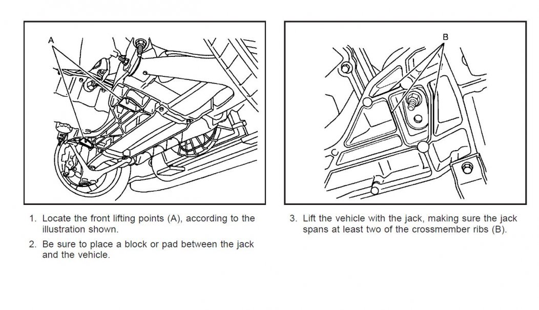

FYI I would like to add something about jacking up the car.
I have owned many special cars over the years and the XLR is the first car that I was not able to jack up the front while the wheels are on the ground and I have low profile floor jacks.
Look at your owners manual for the jacking points. You do not jack up these cars on the side sills as most cars, there is no provision for side sill jacking.
I was able to jack up the back by going in under the back of the car but the front sets to low to go in under the front.
What worked for me was to run the car up onto car ramps, which you have to be careful they don't move, and then you can get to the jacking points from the front of the car.
Maybe someone has a better method of jacking up the XLR but this worked for me.
You can really damage your car if you are not careful.

I found this in the Owners Manual. I don't think my jack is low enough to get under the car to the lift point's.
