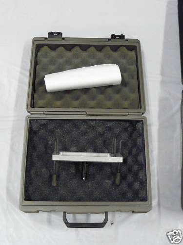

3) DSCC out of mechanical alignment - There's a dedicated alignment fixture (Kent-Moore J-45442) to ensure it's pointing properly; any front end damage (or loosening of the DSCC bracket) can throw the module off. These fixtures pop up on eBay occasionally. (See attached pic.)

J 45442 DSCC Alignment Tool.jpg<strike></strike>
