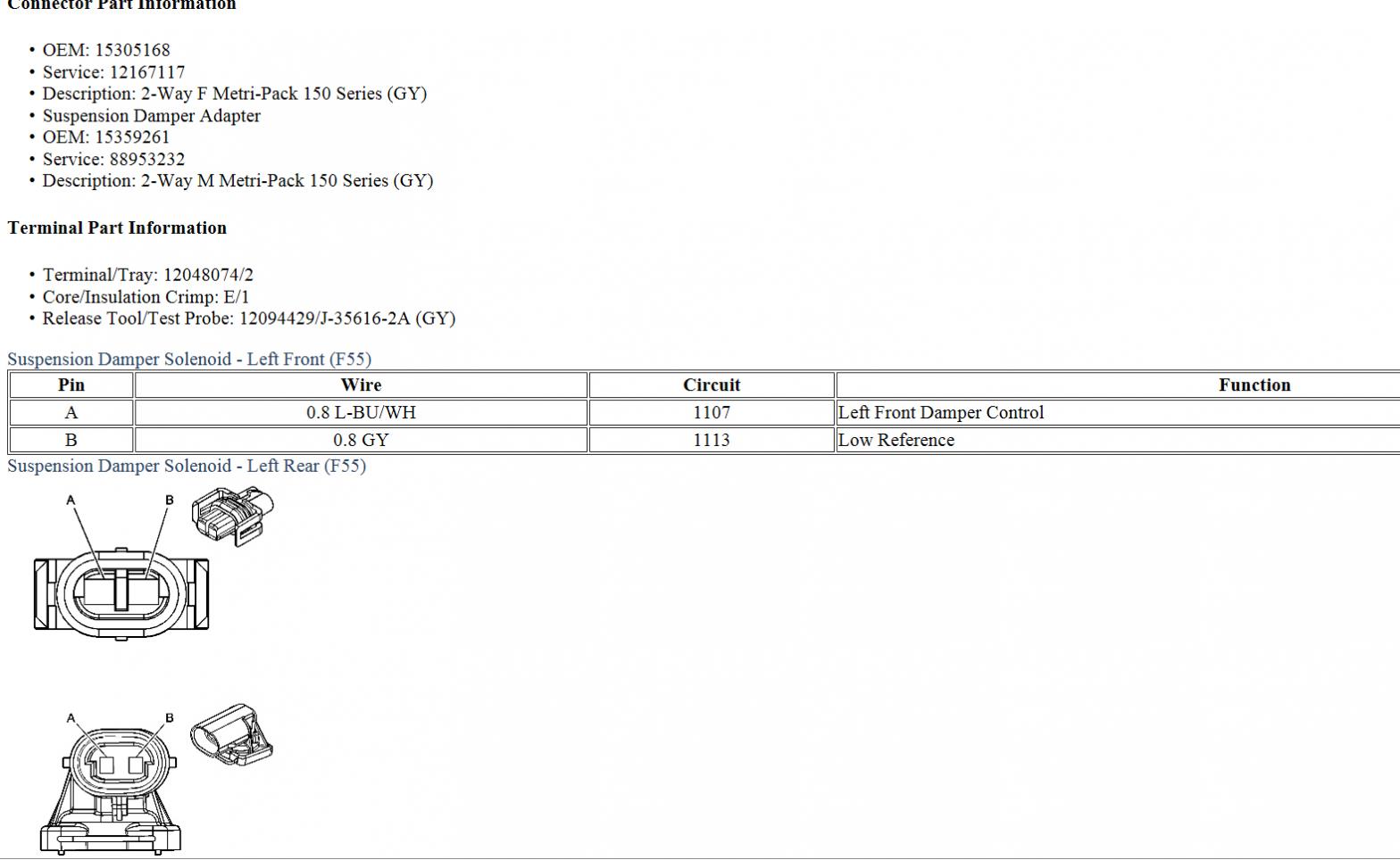

Issue #1 – Service Ride Control
I had all 4 shocks replaced. The fronts were AC Delco 580-135 which did not include sensor. As a result, the Service Ride Control message is on the display. I read posts on other sites suggesting placing a terminating resistor on connecting leads would fool the computer that sensors were installed. This seems like the perfect solution.
Ideally I’d like buy on off the shelf assembly complete with resister and mating connector lead for computer. Does anyone know if such a thing exists and if so, a manufacturer and part # would be sincerely appreciated.
If nothing is available off the shelf, I’ll be relegated to making my own. Would anyone know the ohm and wattage rating of the resistor and perhaps a part# for the mating connector for the computer lead?
