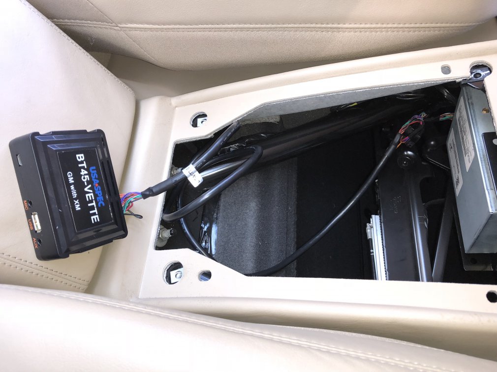

I installed the BR45-Vette in my 2006 XLR yesterday. It works great. Below are some thoughts on the process.

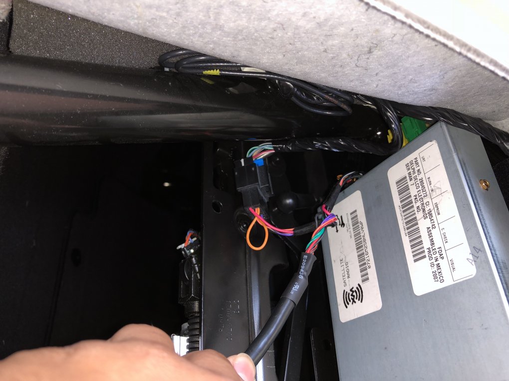

It is easy to install the unit. Just unscrew the 4 Torx head screws in the rear between seat console. Pull the console out. See the picture above.
The XM radio unit is on the top of the opening on the passenger side. One plug must be removed from the unit. It is a little hard to reach but it can be done. There is a Blue locking tab that must be partially pulled out (loosened) to allow you to squeeze the locking tab
The steps below are detailed in the installation instructions supplied with the BP45. Note: the connectors only fit one way.
Plug the male end of the cable included with BP45 into the XM radio where you removed the factory plug.
Plug the factory male plug into the female end of the BP45 supplied cable.
Plug the last connection on cable into the BP45 into the BP45 box.
If all you want is Bluetooth music you are done.
If you want to use Bluetooth for phone calls,
you need to plug the microphone cable into the BP45 box and run the cable to where you want the mic. I removed the center console, shifter surround bezel and heater/radio surround. Then ran the cable for the mic to the front of the car. I have not determined exactly where I will mount the mic yet, I can post more after I do.
If you want you can connect your own USB cable to the BP45. You can use this cable to charge your USB device. I attached an iPhone usb/fire cable to charge my phone. I ran the cable into the center console through an exiting hole in the back of the console under the cover that hides the console mounting screws.

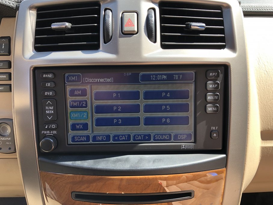

BP45 uses the XM1 channel for the Bluetooth device (music and phone calls) XM2 is still available for XM radio.
Put all the car back together and you're good.
So I have Bluetooth Music, iPhone calls and a charging outlet. I drove a 450 mile round trip today and loved it. Still have things to finish:
Determine final placement for the microphone, configure the display, steering wheel volume control works but the steering wheel preset button doesn't, I will have to investigate.
In general is works great. For me it was well worth the money.
