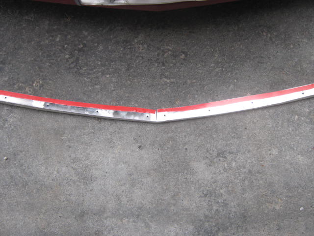

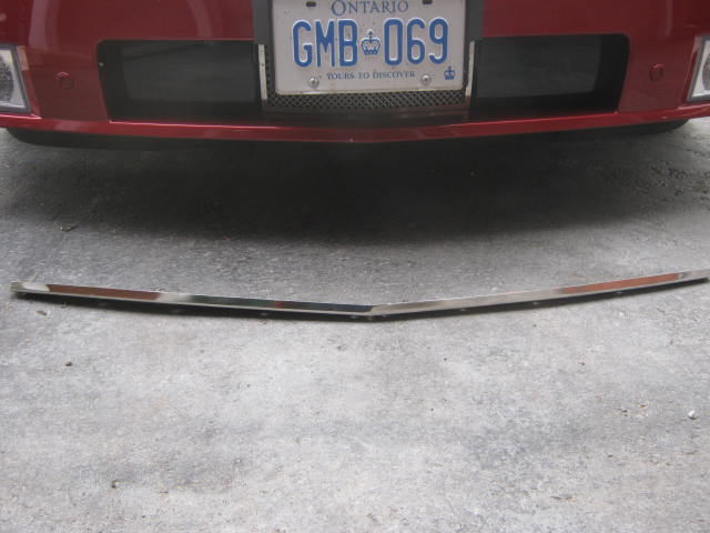

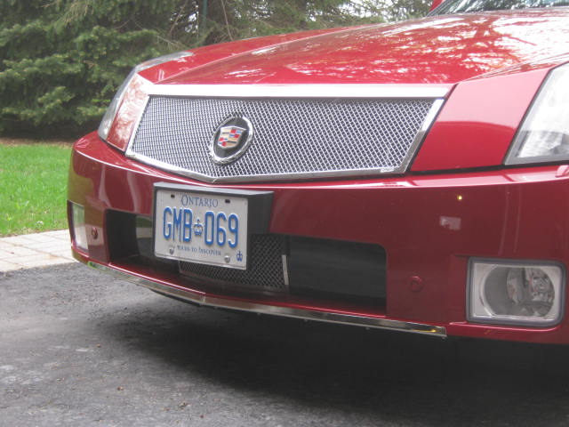

Not for everyone of course! I had some 16ga. (0.060"±) Stainless bent to about 87º and formed to fit the double compound lines of the lower splitter of the XLR bumper. Not an easy task!
I had the leading edge buffed as smooth as possible and drilled and deburred holes that tightly fit the SS screws used for mounting.
I then had the piece electropolished. This process brings the Nickel and Chromium to the surface.
I put high quality double sided foam tape along the trailing edge. Starting from the center, I drilled ten 3/16" pilot holes through the existing screw holes and installed the 1/2" long SS screws by hand so as not to strip the plastic. I removed the backing tape from the foam as I proceeded, drilling one hole at a time while holding the piece tight to the splitter.
I like the look and added protection that it provides to the front.
The Upper and Lower Mesh Grilles are by E&G Classics.
I hope the Photos show up. Harder than the Bling to install!
Email me for Photos.
Gord.

As long as you're happy with it, it shouldn't matter. :cool: I do have a question for you from your pics, are those front sensors in between the fog lights and lower grille?? What are they hooked up to??

I am not sure, but I believe they are for the Adaptive Cruise Control, which works very well. It is a 2008 model.
I had read somewhere that those sensors were behind the opaque plastic covers on either side of the lower grille - perhaps on earlier models.
Apparently those sensors behind the plastic covers did not work if plastic was dirty or something to that effect.

The radar unit for the adaptive cruise control is behind the black smooth area on the drivers side. V's don't have ACC so that is why the lower grille screen goes all across. Supposedly ACC does not work behind the screen and don't know why the V's didn't get ACC unless it had something to do with the supercharged engine. :dunno:

I haven't removed the covers beside the air intake to check, but I do believe the ACC sensors are the ones visible in the bumper facia.
I will check the Service Manual sometime to be sure. I don't know what else they could be for.

The V's didn't get ACC because the area where the module is located is taken up by the supercharger intercooler. Nowhere to put it. Had an '04 prior to my V and never really cared for the ACC. Driving in Chicago area and trying to keep spacing between vehicles, someone always darts in front of you and the ACC applies the brakes--sometimes rather abruptly!! Got tired of one foot each on the gas and one covering the brake!
