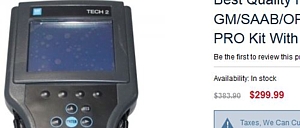

It can be confusing....FYI....there are real ones and then there are fake ones all over eBay.
There are different real ones...GM logo, Saturn logo, Saab logo...plus MACtool, and OTC logos.
There are real ones made by Vetronix, Hewlett Packard, and Bosch.
Any GM after 2003 will require a CANDI module add on.
The fire sale on the real ones was back in 2009 when all the GM dealers were closing. We bought 2 GM real ones for $1100 from a closing Saturn dealer.
One guy got a year in jail for selling fake ones on eBay.
The super cheap $299 China ones can be found in the sponsored links on eBay. See attached pic.
Good luck getting one of those fixed if needed..
