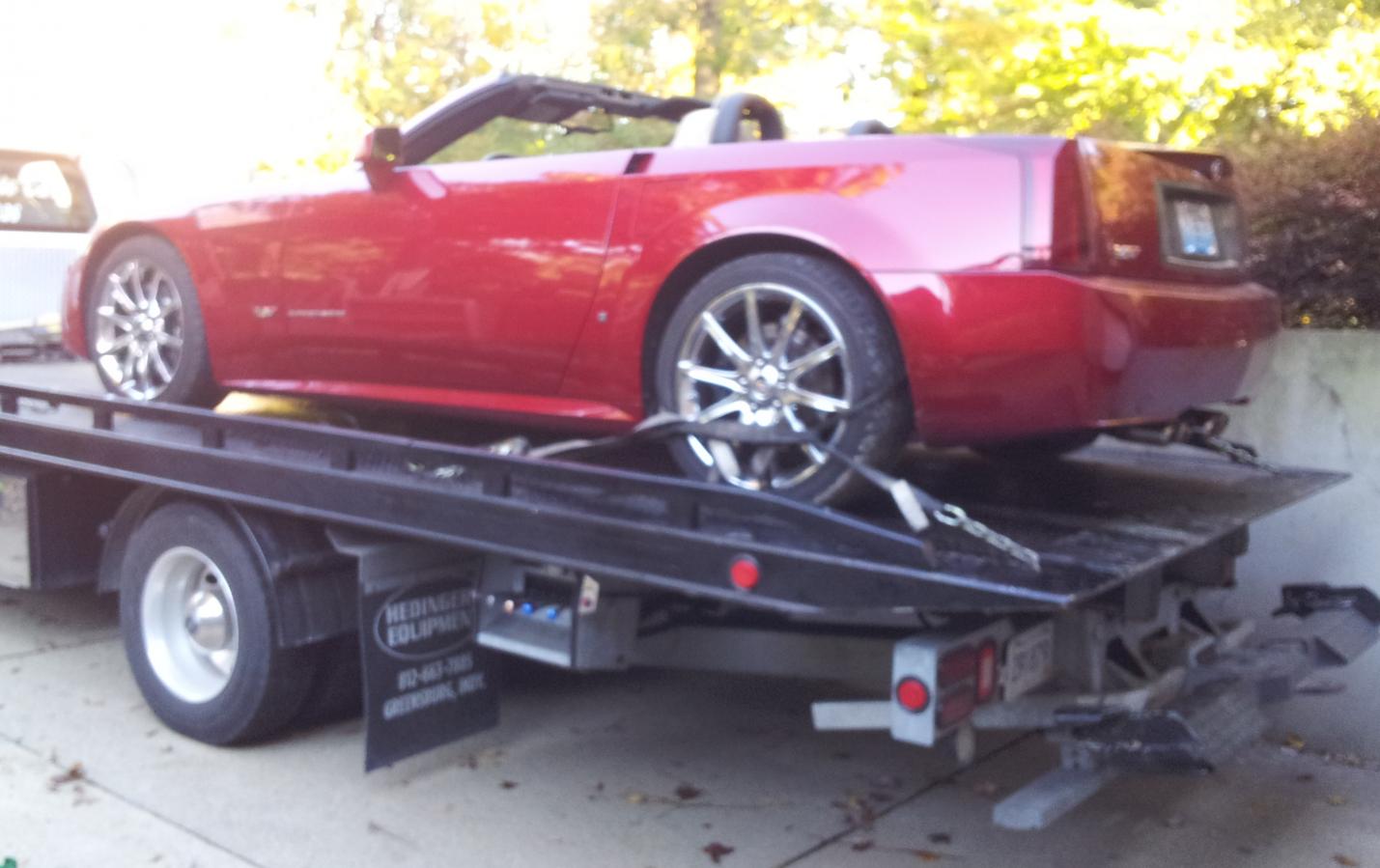

I recommend being prepared for towing, you never know. A roll back is the way to go without a doubt. I didn't consider storing in neutral, but it might not be a bad idea.
FWIW, it's not that tough to shift out of park without power. Remove the shift knob, lift the console, release the lock solenoid with your finger.
Personally, I leave the windows up and the hood unlatched.
This pic is after a major electrical fault and with a full battery. In the summer I don't always put the roof up in the garage.
