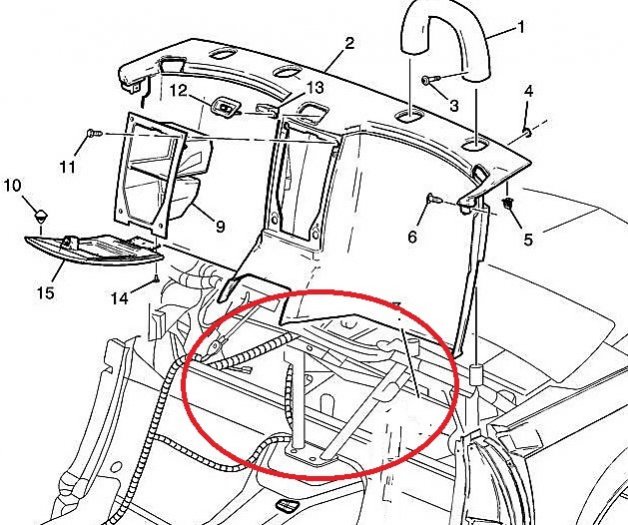

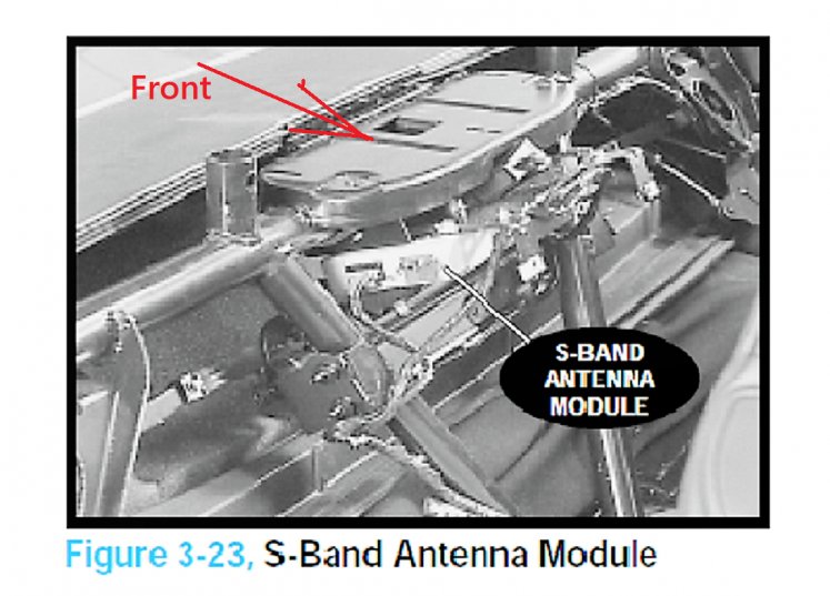

Enclosed are images of the rear rollover bar were the modules could be attched as per the present modules with somes U clamps.
Would one day doing the conversion, i would put the well modules on the passenger side because of some possible amanations from the gas filling area, as far is for the wiring it looks that it can be done without doing some cuttings.
Then the pump could be attached again to the rool bar LH driver side, as far is the hydraulic piping , I would wonder on how to get the piping re direct without making some kink on the piping.... it could be more of a problem.
It is my opinion after looking at the sketchs.
IAN :blinzel:
