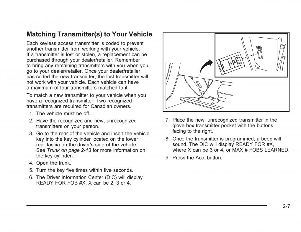

The procedure for programming a second fob when you have one should be in your owners manual.

Thank you for the info on re-programming key fobs. It will be most helpful.
