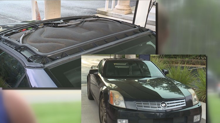

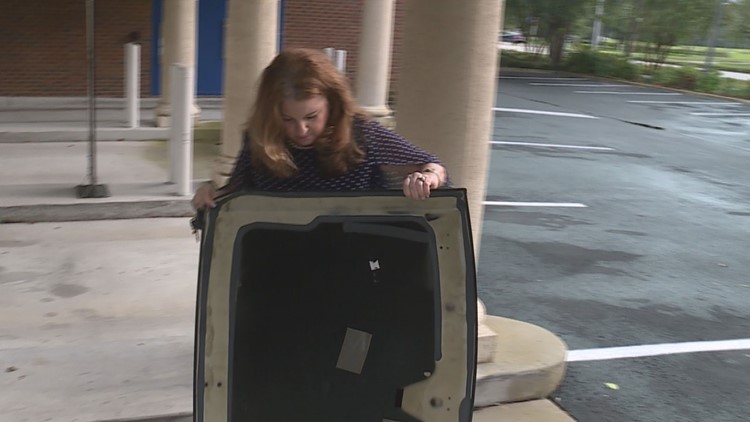

On June 3rd, a 2005 Cadillac XLR owner was driving down a back road in First Coast, Florida, when suddenly, the roof panel flew off her XLR.
Francesca Giannini, the XLR’s owner, bought her 2005 Cadillac XLR new and never showed any structural issues during routine maintenance checks.
A witness who was driving behind Giannini, said the roof panel went airborne and narrowly missed other cars, flying off to the right and coming to rest flat on the grass.
Witnesses in one of the cars behind Giannini said the airborne roof narrowly missed other cars.
