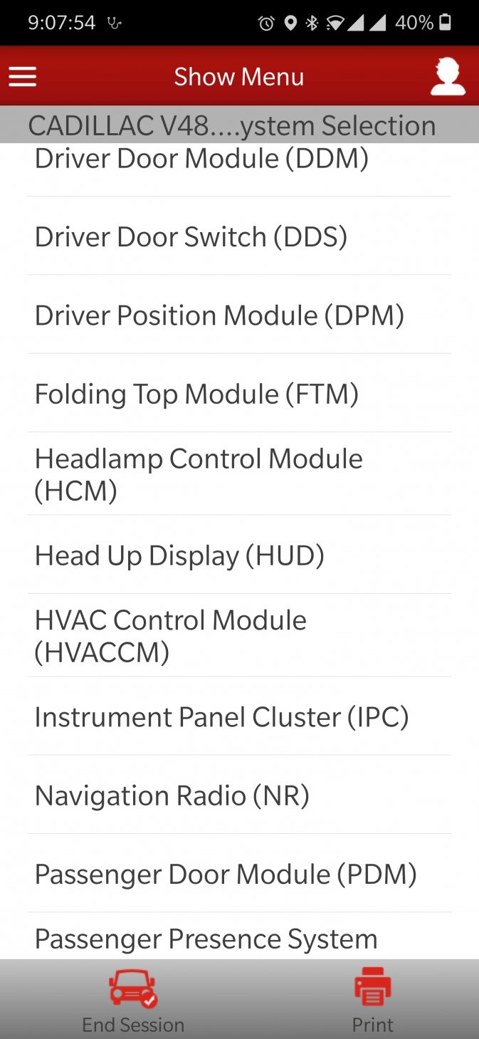

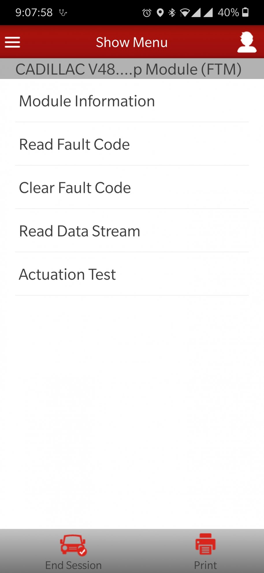

I'm kind of having the same issue here. I need to do the re-learn process, however I don't see it as an option under the Folding Top Module system...
Go into folding top control module and special functions.... trunk release is in body rear end, bcm, active tests just in case you cant release trunk.

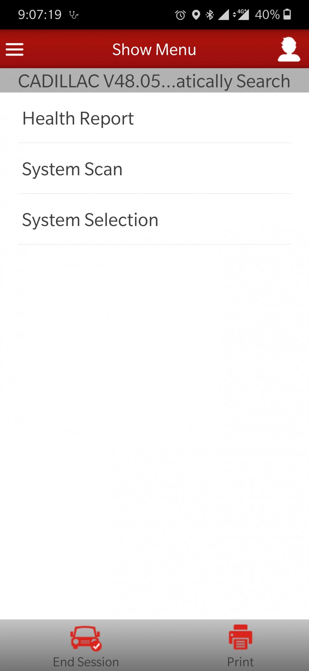

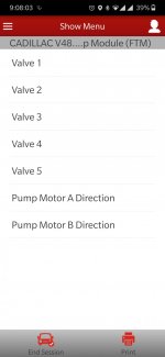

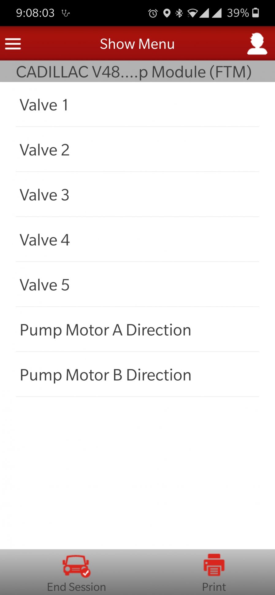

Attached are the screenshots to the tool I'm using. The Launch X431 connector only and Diagzone on an Android, loaded with GM Tech2 v.48.05
Would there be another way to get to do the re-learn process?
