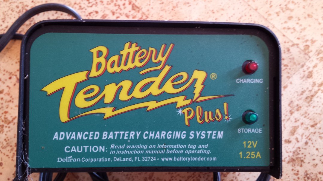

I highly recommend the Battery Tender brand. We have had classic cars and Harleys for years and have been using this brand for a long long time. They always perform flawlessly: never a single problem. ( :pat: knock wood) They come with a 'lead' that you attach to your battery so you just quickly plug it in. If you have more than one vehicle that needs tending they also offer multi units that save a few bucks and also solve the problem of not having enough wall outlets to plug into, but we mostly have the individual ones for convenience.
As you likely are aware, all modern vehicles: cars and motorcycles, especially those with alarms, keyless fobs, auto locks are constantly searching for the fob so they always slowly drain their batteries. Even those without have parasitic systems but are slower to flatten a battery. This is not a problem in 'daily driver' cars as the battery gets topped up by driving. A dead battery is a huge P.I.A. in an XLR, many systems need to be reset etc.

Is the Junior also a 1.25 Amp? (I was not aware of them) I know our motorcycle units are .7 Amp and I wonder if they would be ample (pun intended) to handle the needs of an XLR. The motorcycle ones would likely would work for a classic car without all the parasitic draining systems etc.

Ok, so now you have me curious. My hubby Steve referred to the junior unit as what he considers a M/C unit. They are generally 12V - .75 amp (or 750 mA) so I went to the Deltran Battery Tender website and there are a number of Junior units including a 12V - .75A, 8V - 1.25A and a 6V - 1.25A units of the style you describe. Learn something new every day! Steve was told by a Deltran rep that they generally recommend the 1.25A units for cars and trucks. It is good to know that the Juniors do the job too! :burnout:
