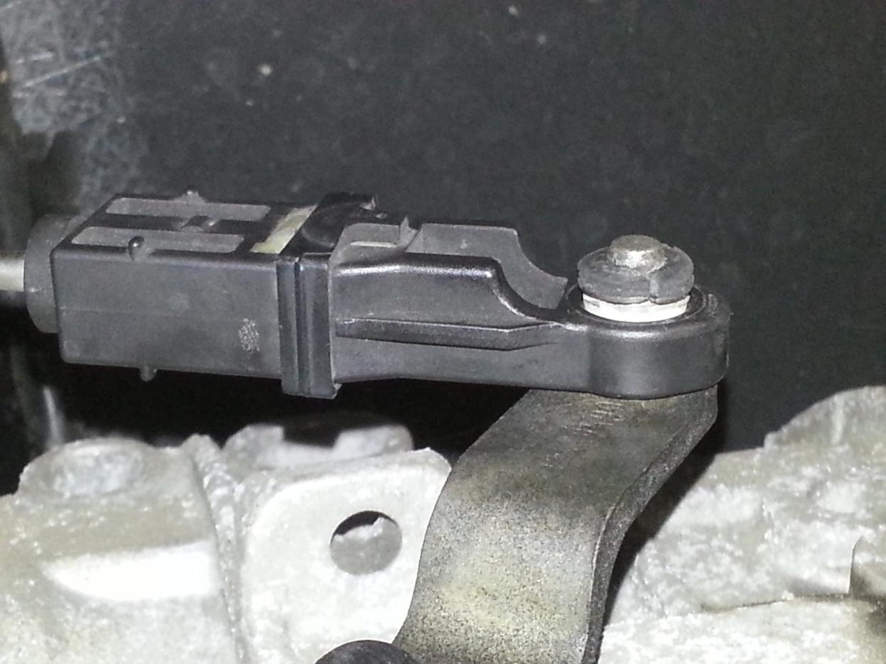

THANKS GUYS !!!!!!! found the problem as you all said the shift cable was hanging and it wasnt touching the transmission .... did a lil of fixing myself so i can move it around in the meatime before i get a new shift cable 20130310_175058.jpg
