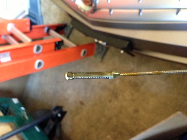

I checked the oil, and the level was maybe a little high (stealership may have put in too much after their last oil change?) and it was a nice amber color -- didn't not look like the chocolate milk I have heard it turns to when coolant and oil mix. The only thing I DID find was a puddle of water under exhaust pipes. I sopped some up off the driveway with a white paper towel and it had no color. I wiped around the tail pipes and it was clear. And I smelled exhaust before shutting the car off and it didn't smell sweet. So I don't think it is burning coolant, though it does seem like too much water going is being burned off.

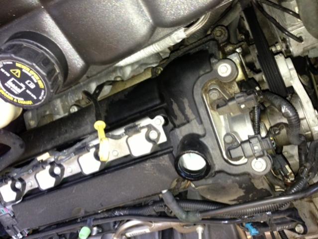

I have a couple of oil leaks... but I took this photo of dipstick and of the area around the oil filler neck to show moisture.
If its losing that much coolant that fast there has to be a major problem but i to would be confused with no puddle under the car or a noticeable rise on the dipstick that doesnt make sense. Has to be one or the other.
If there was coolant in my oil, though, wouldn't the color be off? It has me very confused, too.

We took the cover off the engine and put it up on a lift and checked from above and below for signs of an external coolant leak and found none of that white/blue streaks where it appeared to have leaked. I will go by an auto parts store today and see about getting what I need for the chemical test of the coolant. The dealer is within 5 miles of the house and has XLR techs, but I just can't stomach horrible news right now! I have read of a couple other XLR's requiring head gasket and the dealer charged about $5,000. Yikes. Thats about the cost of a new engine (not installed, just the engine). Thanks for your feedback.
