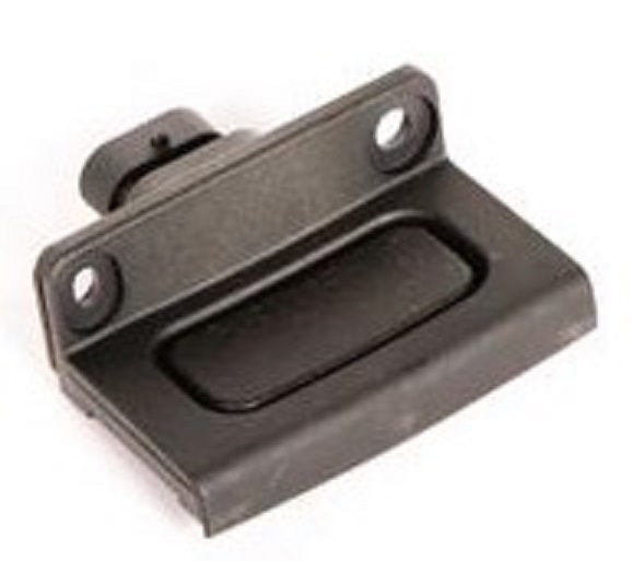

Hi Wandrews2004.
Most of the time the door pad switch is the problem, the switch can be opened for cleaning it from the moisture, I did on my car and it works fine now.
Enclosed are the photos of the pad and a YouTube address that shows you how to do it on a C6 corvette, for witch the pad is very similar or the same.

IAN.:wave: 7-Trunk release switich 20785843-AC delco 1487E-getimage[2].jpg10-Touchpad switch door LH-$12(KGrHqFHJEYE-kdYZYRWBPs-FSJ(W!~~608[1] (2).jpg

IAN.:wave:View attachment 9243View attachment 9244
Thanks Ian! I'll pull the old one tomorrow and save it for cleaning. I'm pretty sure the new switch will cure the problem.
Be careful when pulling the door switch out, hang on to the cable, it can pop back in and is a bit of work to fish back out.

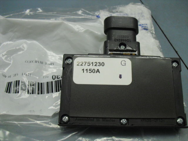

My car, the driver's door switch was intermittent and as a matter of fact, I've ultimately changed both interior and both exterior switches just to be on the safe side. (My paranoia about no parts availability again). Indeed, Ian's suggestion to clean is a good one and mine sit in a box 'for that day'.
I also did the trunk switch (outer) to be a bit proactive - curious, I didn't study it but it sure looks like an exterior door switch yet has a different part number.
22751230 vs. 84190614. Must be some internal difference.

I had that problem with the passenger door when I first got my XLR; I took the release pad off (2screws), unpluged it , and took it in the house. I then took the teeny screws out that held it together (0ver a large bowl so as not to lose any) cleaned the electric pad inside of it , put it back together with those teeny screws, and just plugged it in on the car to check it. It worked!! Then I put it back on the door with the 2 screws that held it on the door! Bingo!! DONE!!!

Sometime the inside connector plates get corroded and just cleaning them makes them work like new again. Take units off door with 2 screws, then remove 6 small screws on back side, I cleaned my with a light abrasive scrub pad. They work like new again,
see pics
