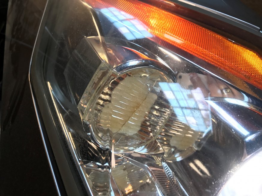

So, I went to look at a 2004 XLR over the weekend (about an hour away). Overall, in very good shape all around. I couldn't test drive it (it was hemmed in at a warehouse, and I didn't call ahead), and the top would not raise (and I've since been told about indexing the windows); the dealer will be following up on that and getting service records, etc.
However, I'm beginning to get more concerned about the left DRL lens (see picture). I've learned enough to know what causes it and how to avoid it (don't turn on the DRLs--or turn on foglamps to deactivate them), and that spare parts are nearly impossible to find. That being said, the condition of this lens sounds like it might/could/should be a deal-breaker. Thoughts? Options? Thanks in advance (also to folks on other parts of the forum who helped provide the background)...

Good afternoon. Just another day in Paradise and only 35 days til Spring. I have seen several XLR's and most headlights are in the same shape... One of a few bad qualities... Cadillac has let us down on being able to get headlights and taillights... Hope you find an XLR that you like. I am sure you will enjoy it.
Fred
I don't think one crazed bezel should be a deal-breaker, but. . . if it bothers you now, it would probably bother you more later on. That being said, there are hundreds of XLRs on the road with this same issue.
You can avoid it by finding a later model (2006 and up) that sported the improved headlights or get lucky and find an earlier model that had them retro-fitted.
CC :wave:
I'm guessing I got very lucky in 2011 when I bought Roxy she had them crazed lenses too.....which I was told it actually came from the bulbs yellow color and not from heat melting the lenses but actually deteriorated the plastic, anyway the dealer shot us a deal trying to earn our business for repairs I guess.....for full replacement of both for $500 I almost said no after just buying the car and having payment, but my wife said I surely regret it later, so I just got them done and paid for on credit card..... this was one time I'm glad I listened to her!
If you are thinking the headlight DRL issue is a deal breaker you are in for a number of deal breakers in your eyes..
I love my Xlr and enjoy keeping it in great shape, even with the challenges we owners facw..
This forum with the Internet will help solve most all issues related to Xlrs.
Good luck, Have patience and most of all..ENJOY!

Our 06 has some "crazy" lenses, but after a while, I pay no attention, wife has never noticed, nor has anyone else but one other XLR owner. Now it's a habit with me to turn on the fog lights which I have replaced with LED's.

The fix was implemented during the 2006 MY. Not all 2006's have it installed. It took time for the problem to become obvious on the 2004's before a revised part could be designed/built and fielded.
That may be a true statement CC, but MY06(model year) had the adaptive headlights; which MY05 (model year) did not; so I'm positive no '05 headlights were used on early build MY06.
My '06 V also had some crazing starting on the drivers side headlight. I almost always turned off the DRL's when driving for long periods of time. I believe the biggest problem is the heat from the lamps and their proximity to the lenses itself. I have since changed both headlights (while units were still available) and have installed LED bulbs in the DRL to reduce the heat. Hopefully that fixes the situation......we shall see!!

If the headlight condition bothers you now, and it would me...........its a deal breaker IMO.

How expensive and how much work is involved in that project? It may just interest me to do that! Mine is a 2005 you think it's much difference to change out? Thx Dan
Dan,
If you look halfway down the tech section, you'll see a thread on LED turn signals/DRL that nerkpowers wrote. It will tell you all you need to know.
Dan,
