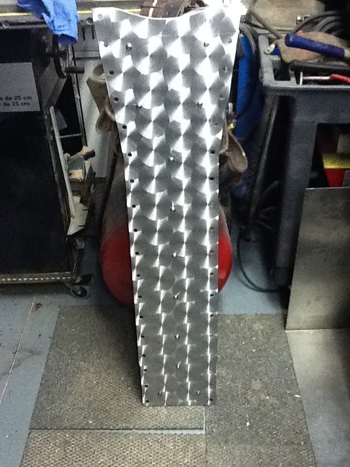

Hey just wanted to chime in about the tunnel plate. I purchased another stock tunnel plate for 25.00. Then I went and got one ceramic coated. After that I laminated the two pieces together via nuts and bolts down the center. The piece on top got heat reflective matting from summit basically the same stuff as pictured on the " elite " one. Your able to use your stock bolts which are plenty long enough just torque them to the right specs. Here's a pic of mine costs under 100.00. It does make a difference. Good luck.<a href="http://s1246.photobucket.com/albums/gg620/topila/?action=view&current=d082173a.jpg" target="_blank"><img src="http://i1246.photobucket.com/albums/gg620/topila/d082173a.jpg" border="0" alt="Photobucket Pictures, Images and Photos" /></a>
Another tip if your trying to cool the tunnel area and give yourself a little better flow and looks. When I removed the h- pipe I brought to my powdercoater and also had ceramic coated. It keeps all the heat inside and expelled through the exhaust. Might add it looks really nice too. Cost 100.00 bucks. All this was easily done without a lift but would definitely make the job that much easier. Coati if you wanna sell your stock plate pm me.

I have upgraded my tunnel plate from getting the recommendation from vette guys. I went the more DIY way buy doubling two stock plates together. I posted a thread all about it if interested. It does help stiffen the feel of the car and IMHO helps keep a conv. aligned. As for the heat aspect of the plate it hasn't gotten that warm here yet but should help reflect some away. On the other hand once that metal gets hot it's just gonna radiate. I ceramic coated the exhaust something learned through racing. Good luck.

Steve your exactly right you can just get the matting from like summit or so on. My tunnel already had it applied and I didn't want to cover my work. I believe it should be on the underside of the plate not top side to be doing what it's designed to do radiate the heat away. If you put the matting on the plate make sure you leave clearance around the mounting surfaces so you get the proper torques. Another thing I've heard is people making heat deflection plates and mounting on the top cats. That's where a lot of heat comes from also. Yes any plate off a c5 or c6 will work.
