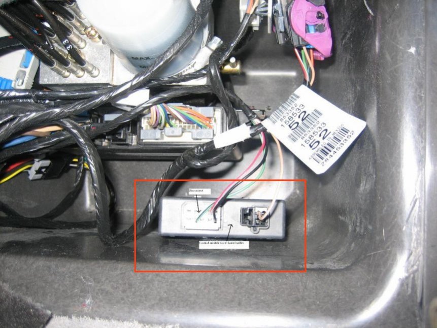

Not to my knowledge, baffles will not open or close if engine is not running. Are you saying the vehicle isn't able to run? An easy way to see if they are working is to go too the trunk and open it up, in the left hand corner open up the lid. start the car & cut the red wire which will deactivate the baffles, now touch the two wires together and you should hear & see the baffles open up. i have no idea why you expect exhaust baffles to work without power to them. All those pictures I have posted should be of some value with your project. Good luck

Hi Alan, I think my vacuum actuators are working as they are supposed to, the part I think I have that is bad is the control module, it's located in the left side cubby hole and is mounted to the back part of the box. Please let me know if you can part with this component? Stan
