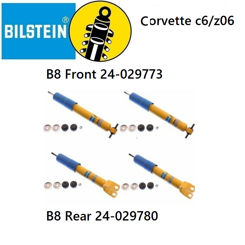

Find enclosed the parts numbers for the front and rear shocks absorbers, they are what the members reported their experiences with this change on their XLR.
The B8 Bilstein series is for the sporty driving without sacrifying the ride of the car however it will lowered your XLR.
The B6 series is for the regular OEM ride of a c6...who can use the same
XLR mag shocks ( as an option )
Also a regular c6 OEM replacement shocks could be an economical way of doing the convertion.
