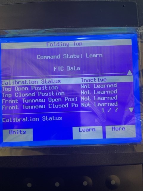

My rear tonneau would not deploy. I hooked up the Tech2 and I really dont know why but I pressed "clear all" ( i think) I remember it said "calibration active" before I pushed a button. But everything just quit working. I had to open the trunk from the bumper, released pressure at the pump, lowered it all and closed trunk. see attached photo. this is what I see on the Tech2 and am stumped! thank you for any help in advance.
You may be able to do a reset by making sure everything is shut ,windows up top locked and trunk latched. Open hood and disconnect battery for 4-5 minutes. Just make sure you dont lower the hood with the battery disconnected. Sometimes the car will reset if not its going to be work to sort it out.

Thank you, I will try that!

Success! Thank you.

.View attachment 14716
With the GM Tech 2 you have to have a candi modular as well
