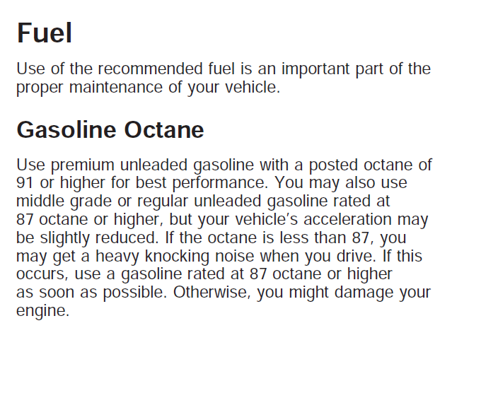

Fuel grade 91+
The owner manual recommend to use hi grade 91 octane,or higher, since I purchased this XLR I run it with 94 octane, including an additif for cleaning the fuel injectors.
My engine now runs smooth and the power is available quickly at the touch of the gas pedal.
For the long trips I used some time the regular grade, however I can feel the differents when accelerating suddenly.
Since we are low miles drivers, for the small different price on a full tank, I would fill it with premium 91 octane or more,this way the engine stay clean, runs better with a fine fuel mileage.
