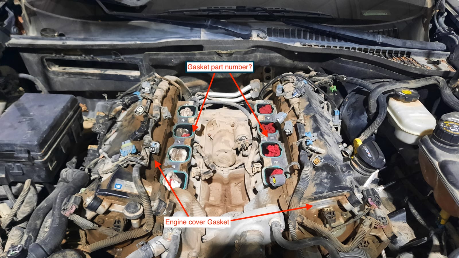

Hey XLR people! Need your help with identifying some part numbers for accuracy.
Doing engine bushings, change all hoses, and since the supercharger has come out, gaskets!
As you can see from the picture below, oil residue coming out of the engine covers and baked there.
Those are the engine cover gaskets, but which are the other ones below?
Thanks mickeytee,
So for reference..
R, Cylinder Head Gasket12613034
L, Cylinder Head Gasket12613033
R, Valve Cover Gasket12576394
L, Valve Cover Gasket12576395
Rear rubber seal for S/C intake12584008
S/C Gasket12590737
Unfortunately the rear air intake boot is discontinued, no longer manufactured part no. (12584008).
What's the best alternative?
