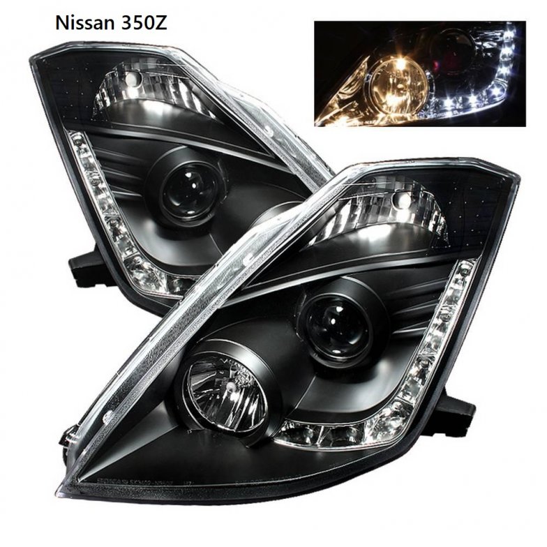

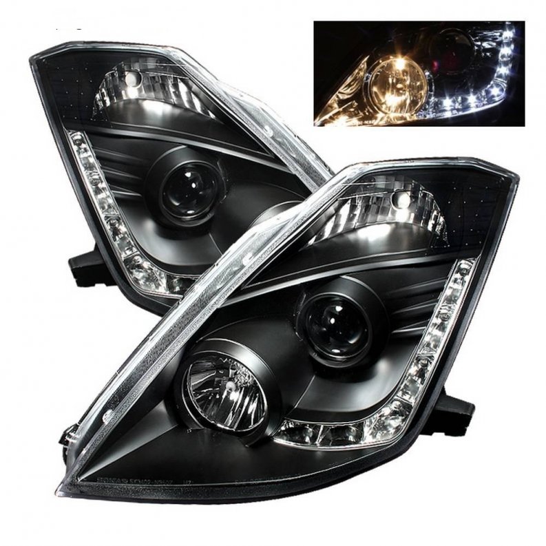

Hi XlR Owners.

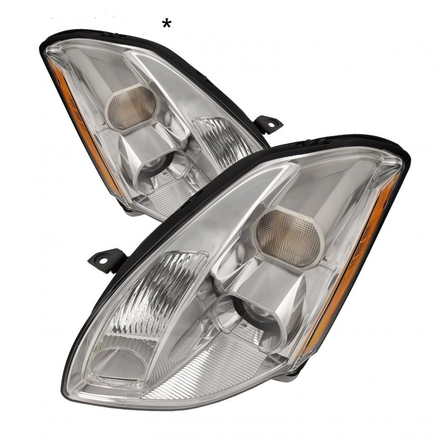

After a search for other cars headlights that could fit on our XLR, guest on which car this lamp fits.
IAN
Hey
Which year ? My friend has an '06 Nismo and have often thought his headlights would be a close match to those on my V. Just do not know how close, is all.
Bill
Wouldn't that be something if they fit without too much slicing and dicing. Fantastic!
Hi Bill.
I believe that the 350z ended it in 2009, and the Nismo in 2006.
However the lamps look the same, this lamp could be an answer eventually for a replacement of the defective ones on the XLR, their prices are OK and the choice of bulbs types and models are available on the after market.
Your a fine reader.
IAN :wave:

we had a post on here or the other forum with about 200 lights that "look" the same and no were near fit. These where on there. 2 or 3 people went to keystone and unboxed every light that appeared to be close and photographed some of them . I would love to see one that would be close. Just remember unless you want to buy new fenders, it needs to be smaller than the opening .You can fill In around the light easier than you can cut and modify the plastic fenders. either way unless yo udo it yourself at 50-75$ an hour for a shop to do it may just get expensive. The prices continue to drop and the supply increases every day with all the totals out there. they will be 1000 1300$ in a year for decent ones
You...light up my life...You give me hope, to carry on...
...The prices continue to drop and the supply increases every day with all the totals out there. they will be 1000 1300$ in a year for decent ones
I guess that would be an improvement though it's still insanely overpriced I find.
So that was a rather pricey headlight, even when new. It's somewhat passé technology now so if I managed to smack one, I'd certainly consider building something else. :(
The whole XLR 'lights' issue is and apparently has been, completely out of proportion price-wise imho. Maybe it's time to seriously consider getting some knock-offs made in such quantity, we could put the whole gouging pattern to bed once and for all. ;) Make them so inexpensive, all the other folk would be looking to swap to these rather than vice-versa! :lol:

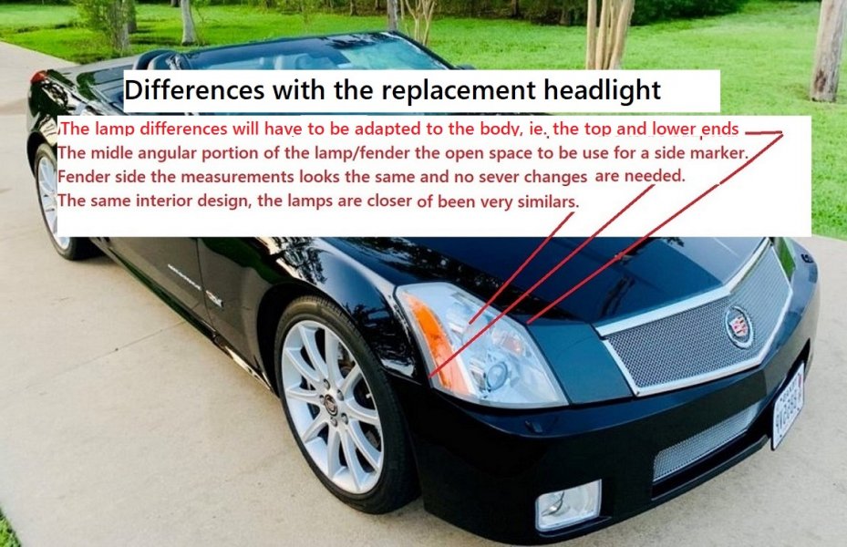

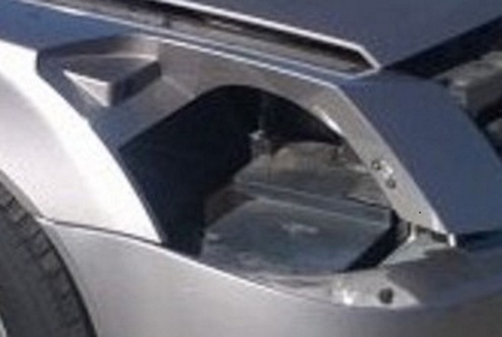

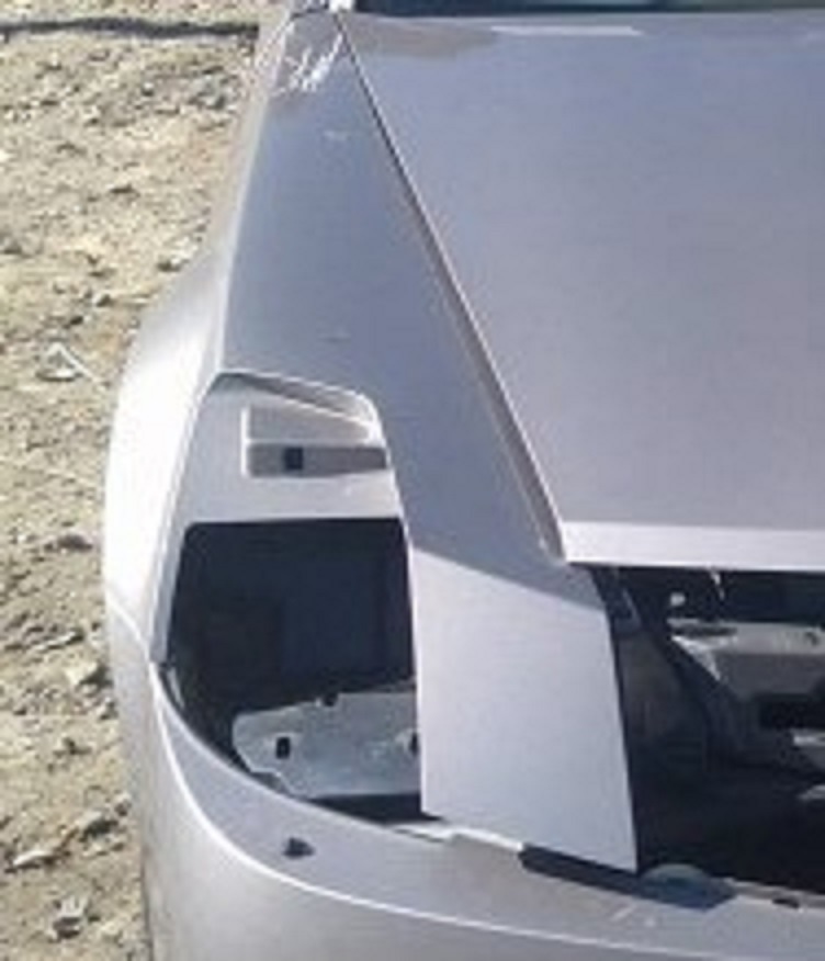

Enclosed is a photo that shows an XLR with no lamp, it shows all kind of spaces to adapt a similar lamps that look very alike.
The experience of someone doing that type of conversion as far as I know is nil, that is why I am trying to bring up this possibility.
You as a Corvette/XLR repair shop, it would be welcome by the XLR owners to do that kind of conversion, perhaps the 2004,05,06 07 XLR are not the ones you mainly looking for business.

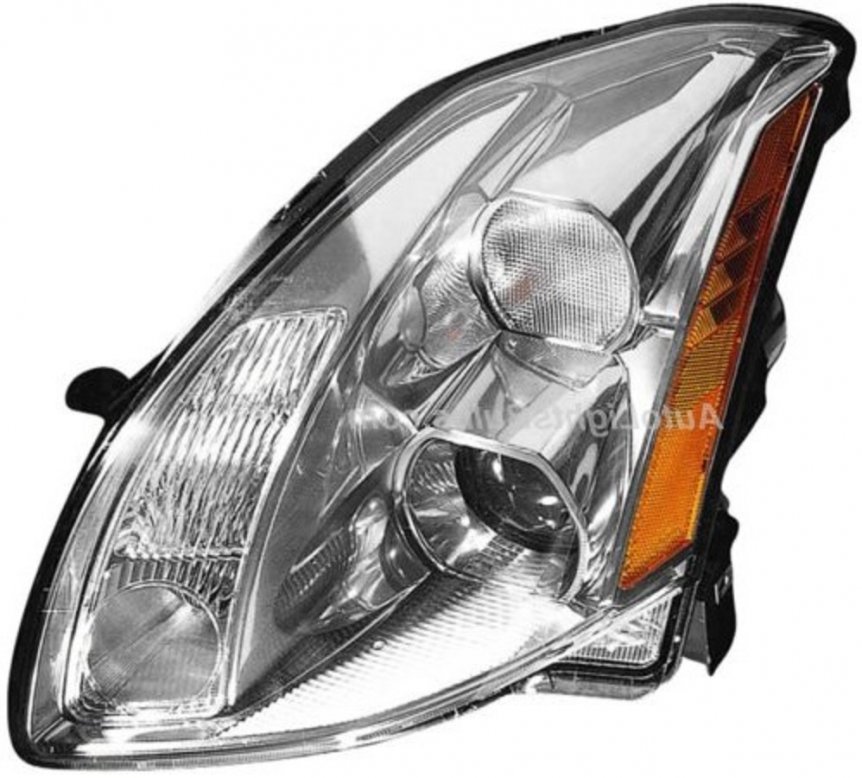

Hi Gord.

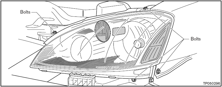

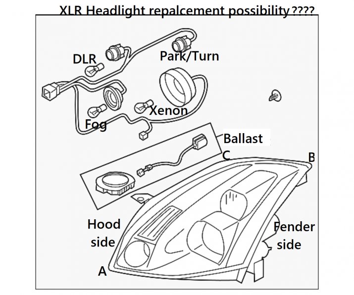

Attached is a drawing of a lamp with the very similar XLR design, with the very close measurements as per the drawing shows, point A to B and point A to C, obviously the fitting could be a reality for the replacement of the old or smatch XLR headlights.
The harness seam to be similar then the XLR and have the same features, so doing the conversion could be not that hard to make.
The car headlight was introduce also in 2004, like the XLR and it is of a hi quality and not a copy, may be the same Asian parts supplier that supply most parts for the cars in the North America cars.
That lamps could easy fit with in the opening fenders of the XLR, a trusted good body shop could do the changes.
The lamps are available new or Used and also on the after market with different designs, with HID or Allogene bulbs, the cost are fair….. that could be a fine choice and a very good availability for the XLR owners.
IAN :thumbsup

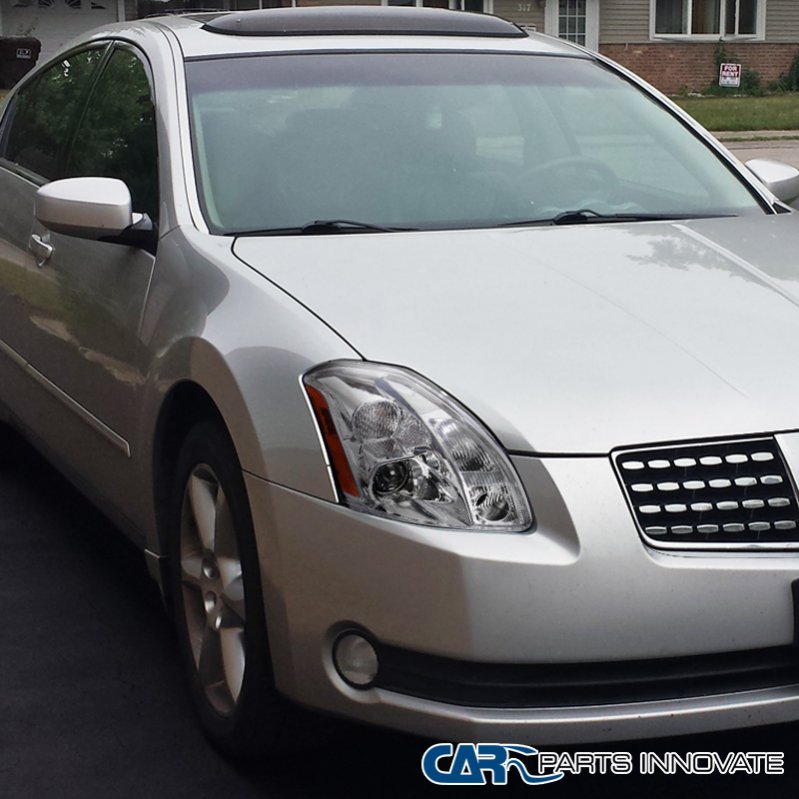

and here is that light in a car. compare the lines. Its a nice looking light and It could be made to work. but it would require cutting up the fender and the hood, the core support the fender apron. Just not worth it. Look at what lights have sold for not what they are asking. I Just bought another almost perfect 08 light Friday from a salvage yard for 1800 Its insurance quality. That means it is very nice. And I think most people on here will feel their 06 -07 -08 are worth more than 10,000 for 1500 -1800 for light unless you need both it would be costly to modify two headlights custom fit them and save much money. That would be fine if there were no replacements but there are. People look on ebay at the listings that are active. Go to the sold items and see what they sold for. Then take 20-25% off of that and that is the value that they can be bought for from salvage yards. eBay charges fees,, paypal fees higher shipping insurance fees. Salvage yards have their own delivery network and don't pay ebay fees. I monitor every headlight and taillight sale on ebay and have the listings of over 150 sold over the last two years so I do know what the prices are. If anyone wants to look for lights . I just found the fiberglass mold I made 3 years ago when I bought my first xlr . It is a fiberglass replica of the headlight lens. I carried it with me and any time I saw something on a lot that looked close I would compare. You learn a lot from doing this. That was back when just fair lights were selling for 3000. I bit the bullet and paid the going rate and still look for a deal but pay what the yare worth when I find them.maxima light.jpg
:dunno:
IAN :thumbsup

Good search, however what are you talking about affirming the hood as to be cutted, please see the fender image That I have previously supply to the readers.
As far is the price that your stating are way up, with what I have really seen, it is a matter of looking at the proper place ( I guest ) as far for the quality, they are the same as the XLR as the supplier could be the same.
As far for the lamp measurement is, if you take ( from the drawing ) the park/flasher drawing measure of 3 inches as a guide (also for the readers ) it will shows that, on the '' side fender'' are the same as the XLR, now the '' hood side '' it would be a bit shorter of the XLR, so that means that the lamp has strong chances to fit within the XLR fender.
This lamp is very alike the XLR only the septic would be looking at the wrong place.
What is next now.
IAN :dunno:

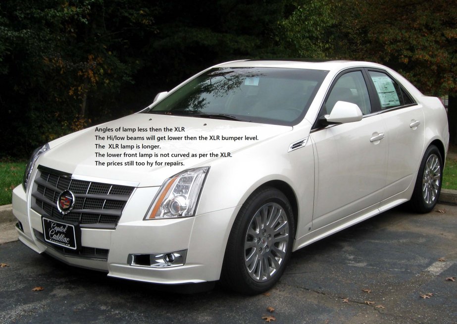

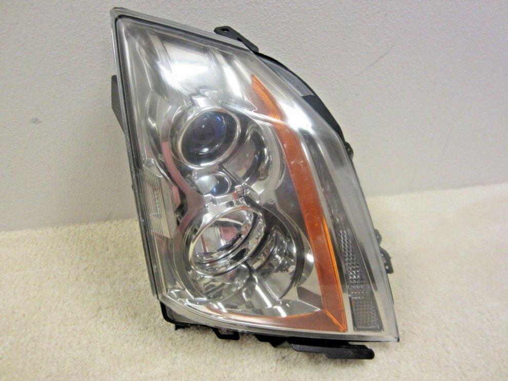

we looked at that one several years ago its too wide. I may even have an old damaged one I can sit in the fender if you like .The better option is the 09 cts .its smaller. that way you can make a housing painted to match, set the headlight In the housing and it may not look too bad. I ordered an old damaged one off ebay for 50$ and will take a photo when it gets here. I have access to 1000's of lights should anyone want to see how one may match up. I am not against this idea at all. just needs to be able to be done with a minimum of expense and work .
Hi Sally.
I would try the one you have in stock first, as it is of the same low profile style headlight then the XLR.
The CTS headlights has the same style then XLR but has so many different measurements and of a higher body style
It would be nice if that could be done, I doubt very much. I have made a search on all Cadillac and they all have some differents measurements for a higher body style.
The tabs of both lamps need to be removed, the headlights ballasts has to be relocate.
At the lower of the lamp, a plate with studs with the dimensions of the XLR has to made to secure the lamp in the same place then the XLR, the present nut of the ballast ( relocate ) can be used for putting studs in it.
These are some of the changes to be made to get the old lamp of your stock in place and it would not be costly to try, if that work we will all be very happy for yourself. ( and for all of us )

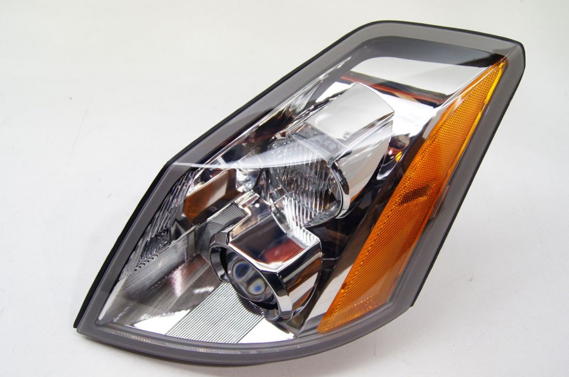

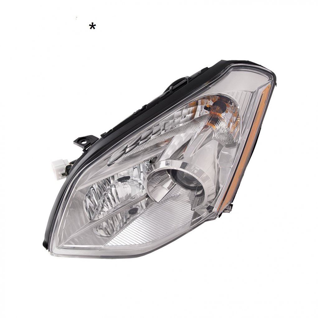

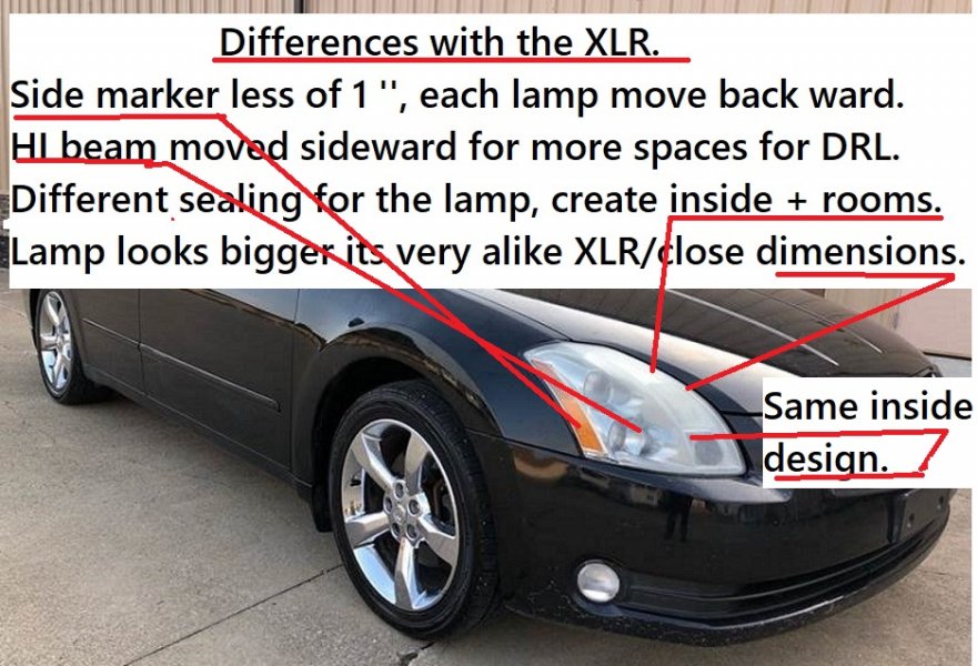

Hi XLR owners.
Here is an update and a recent search for the replacement of our present old lamps and not available ( new ) from GM.
The lamp is available used, with Halogene bulb or HID at some very economical prices and it is also available on the aftermarket in OEM or with similar interior design.
Would I had a serious need for it, I would do the changes, my present Headlights were replaced 4 years ago on goodwill 1/3, 1/3, 1/3, shares expenses by my Cadillac Dealer.
As you can see ( on photos ) both lamps looks alike and I believe that it could be fit for the replacement on 2004, 05, 06 XLR, with owners of small budget.
A fine body shop could be or a DIY been able to make the conversion.
It is a project for the know/how guys.
