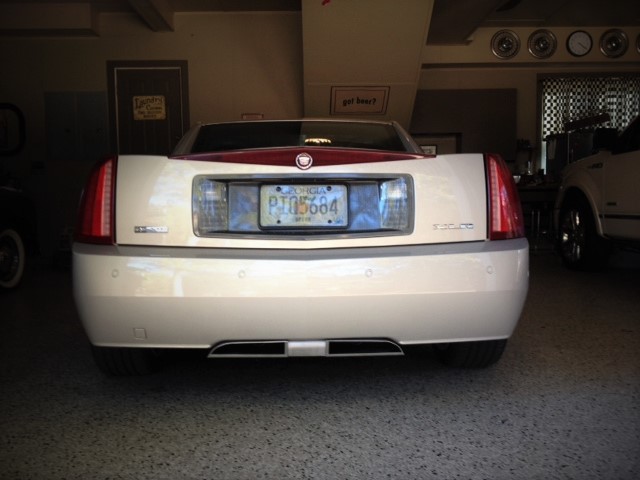

I've just recently had this one made for my Base model - not as "exotic" as the 09 version, but it's an improvement over the stock tips in my opinion. added Cadillac logo in center since in second photo.
It's better looking than the OEM tips. Any pictures of the emblem used? Does yours have a heat shield? I'm headed to the shop to remove the tips now.
