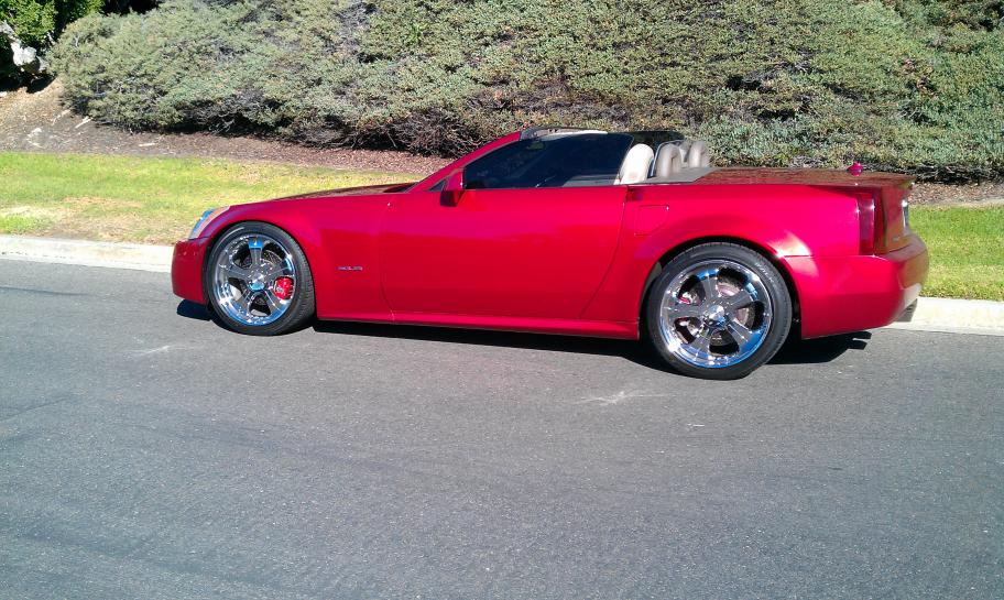

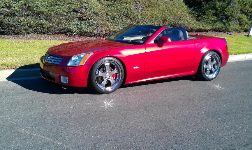

I know this is well after you finalized your wheel/tire sizes, after all your trade studies.
I have a staggered set of Maya 3 piece 20's on my 2005 - 9" on front and 10" on back. The tires are Falken Azenis (Z rated) = 245-40 front and 275-35 back. They fill up the wheel wells pretty good. I did have to lift the rear a bit to keep from fender rub (inner and outer) - the rears are 12% taller than the stock tires - required speedo recalibration (so did my rear end gear ratio swap to 3.42).
Believe it or not, these rims were installed by the dealer at delivery in 2005 (Lund Cadillac - Phoenix) for a $9K premium! The tires have been replaced and are almost new (I have ~40K miles on the car now).
You wanted side photos (in another thread about the 3.42 gear ratio swap) - so here you go - in the wheels and tires section...
Let me know if you want additional details about offset or shots that show the tires relative to the fender (like your pictures).
View attachment 4246View attachment 4247
I like the red painted calipers that are on your car. How much did those cost to do?
Red Calipers
You may laugh, but I did them myself, while doing a brake job. I used a kit by Dupli-color, Caliper Paint Kit (ceramic). The kit includes the cleaner, a small brush, masking tape and enough paint for more than 4 calipers. It comes in several colors. The kit is about $20. The paint is slow to dry, so you have to be patient (overnight). I also painted the outer brackets with the "chrome" paint, just to help set it off.
It took several hours to thoroughly clean and mask each one. I was able to "cut in" the paint around the XLR logo. I polished the XLR logo with my Dremel tool, to make them shiny.
I know some people send them out for powder coat, but that requires disassembly and bleeding (and more time). I was too lazy...;)
