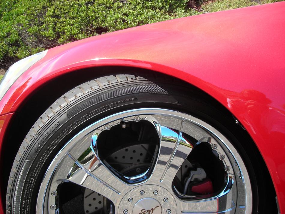

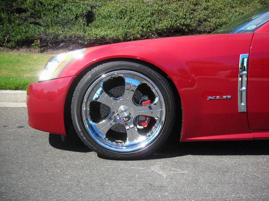

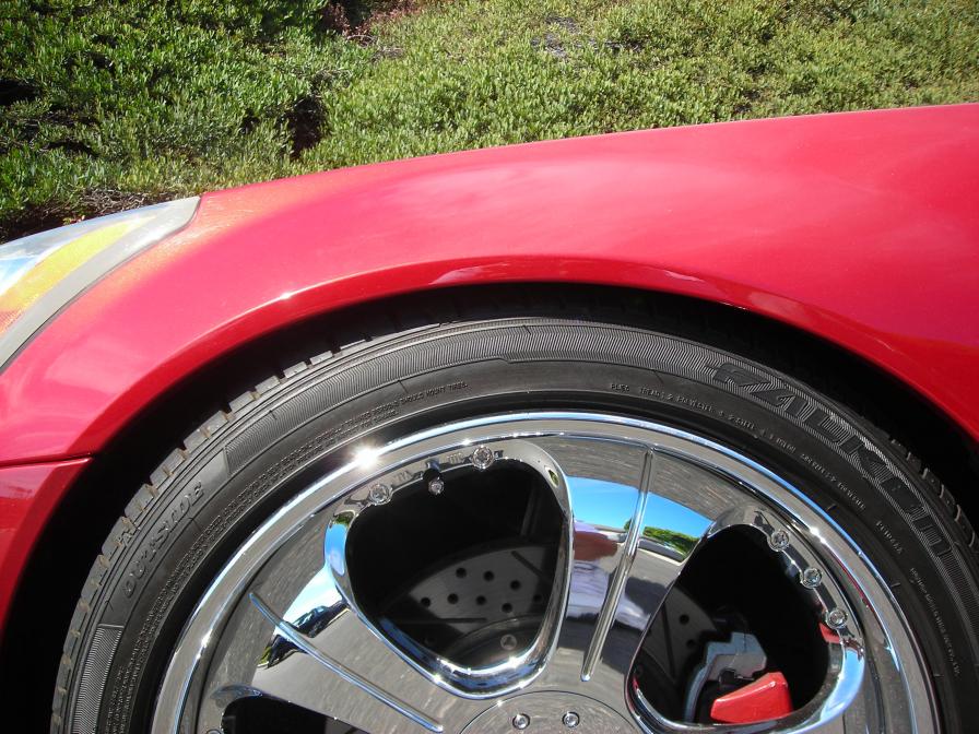

You may laugh, but I did them myself, while doing a brake job. I used a kit by Dupli-color, Caliper Paint Kit (ceramic). The kit includes the cleaner, a small brush, masking tape and enough paint for more than 4 calipers. It comes in several colors. The kit is about $20. The paint is slow to dry, so you have to be patient (overnight). I also painted the outer brackets with the "chrome" paint, just to help set it off.
It took several hours to thoroughly clean and mask each one. I was able to "cut in" the paint around the XLR logo. I polished the XLR logo with my Dremel tool, to make them shiny.
I know some people send them out for powder coat, but that requires disassembly and bleeding (and more time). I was too lazy...![]()

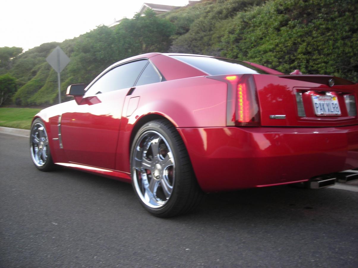

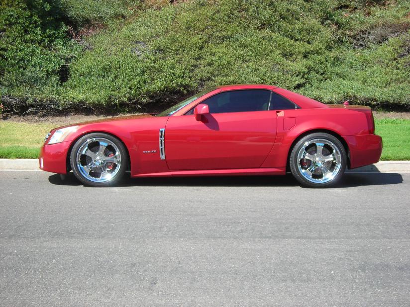

Although, they sure look good standing next the XLR. They came off a custom Mercedes show car (trailer queen) with nearly brand new tires (275/30/20, 225/35/20) Falkin rubbers. I'll have to switch up the fronts for 255/30/20 P-Zero run flat. In turn I'm trading the 225/35/20 for a wax and polish on the XLR and the SL500.
