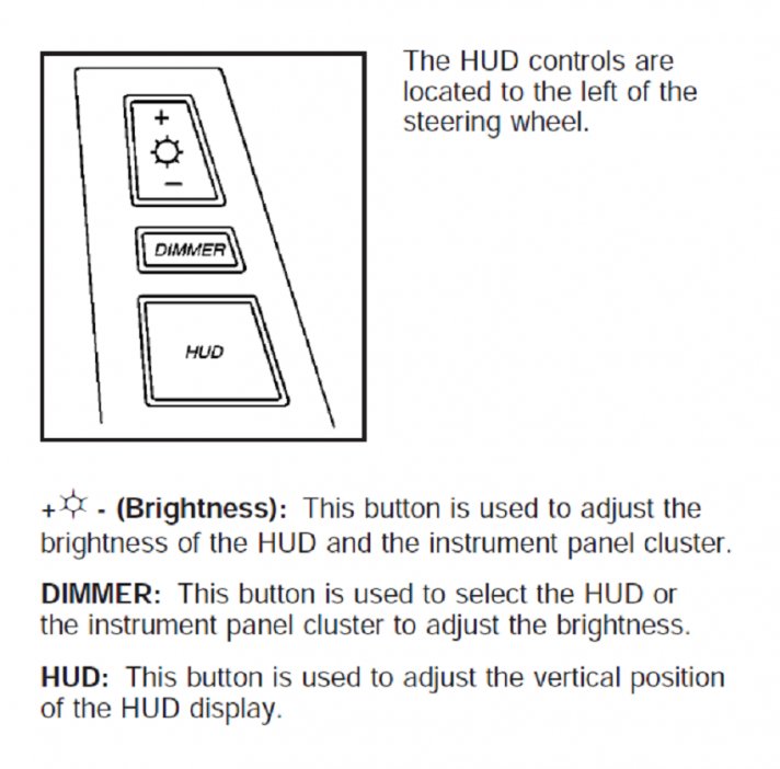

Hi Tom
The Dimmer switch in the center control panel, is for giving you the choice for the +/- brightness of the HUD or the CLUSTER.
Then you make the choice.... the above switch will adjust the brightness of your choice.
The Lower switch HUD is to adjust the Hud at your level vision desired.
If that do not works then your XLR has an electric problem ( the control switches, the grounds, the connections corroded or the HUD fuse on the BCM fuses block).
