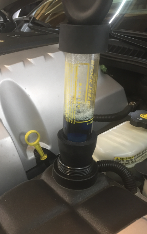

Sorry to say it sounds a whole lot like a head gasket issue. After running the car to temp the cooling system is under pressure. When you shut off the car the coolant remains under pressure while cooling off. That is when you can get coolant into the cyl, showing as white smoke when you next start it. Suggest you try a block tester kit. they are cheap ($30). Comes with blue fluid that turns green-yellow during the test if exhaust gas is detected in the coolant. A Compression test of all cyls would be next to see if you can isolate the breech if you fail the block test. Here is a pic of the block test kit with blue fluid I am talking about.
I did as you suggested and got the equipment from AutoZone. The reagent cost me $10.00 and they will actually provide the tool at no cost. The test came back negative and the fluid stayed blue. When I did the test the coolant level was about an inch down but I can't say where it had been in the past.
