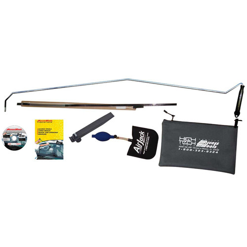

I agree, you can do it yourself with a plastic wedge, airbag and a long hooked metal rod/wire. If you call a locksmith they will use the same tools. I think you can buy all these things at a harbor freight store. Then you will have them for any future situations on any vehicle. I have a set of these tools and can get into any car.
That kit you have in the picture won’t do it. The rod with the hanle is a few inches too short.
