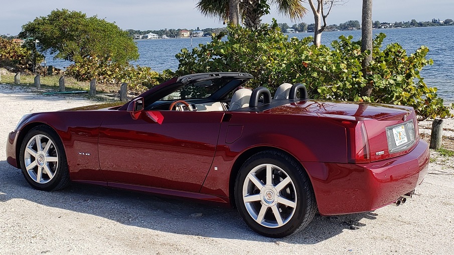

This morning I pulled Fred (paint color infra red) out of the garage and the drivers inside door switch would not work. I tried the passenger side from the inside and it worked fine.
