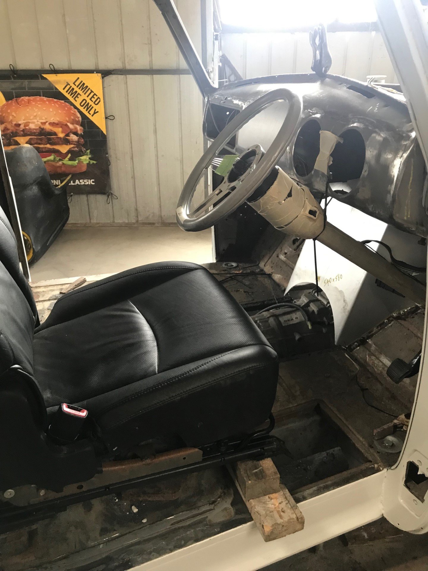

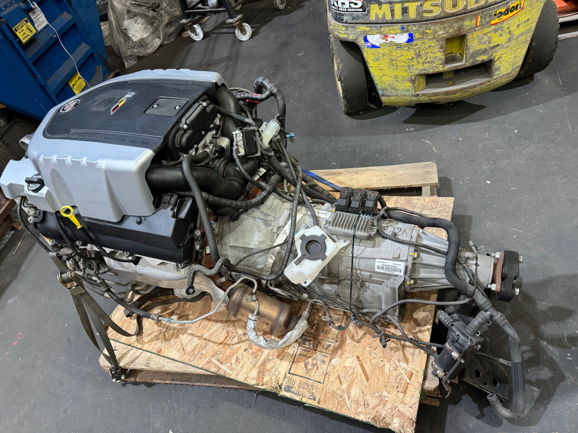

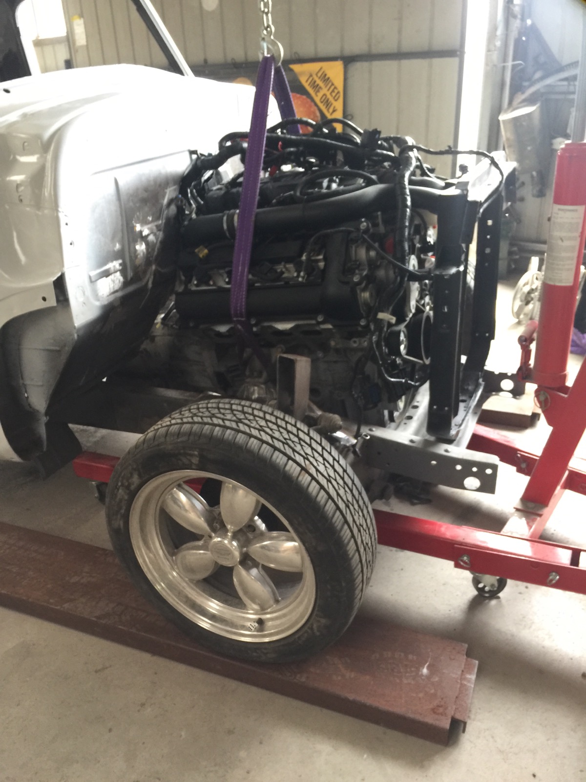

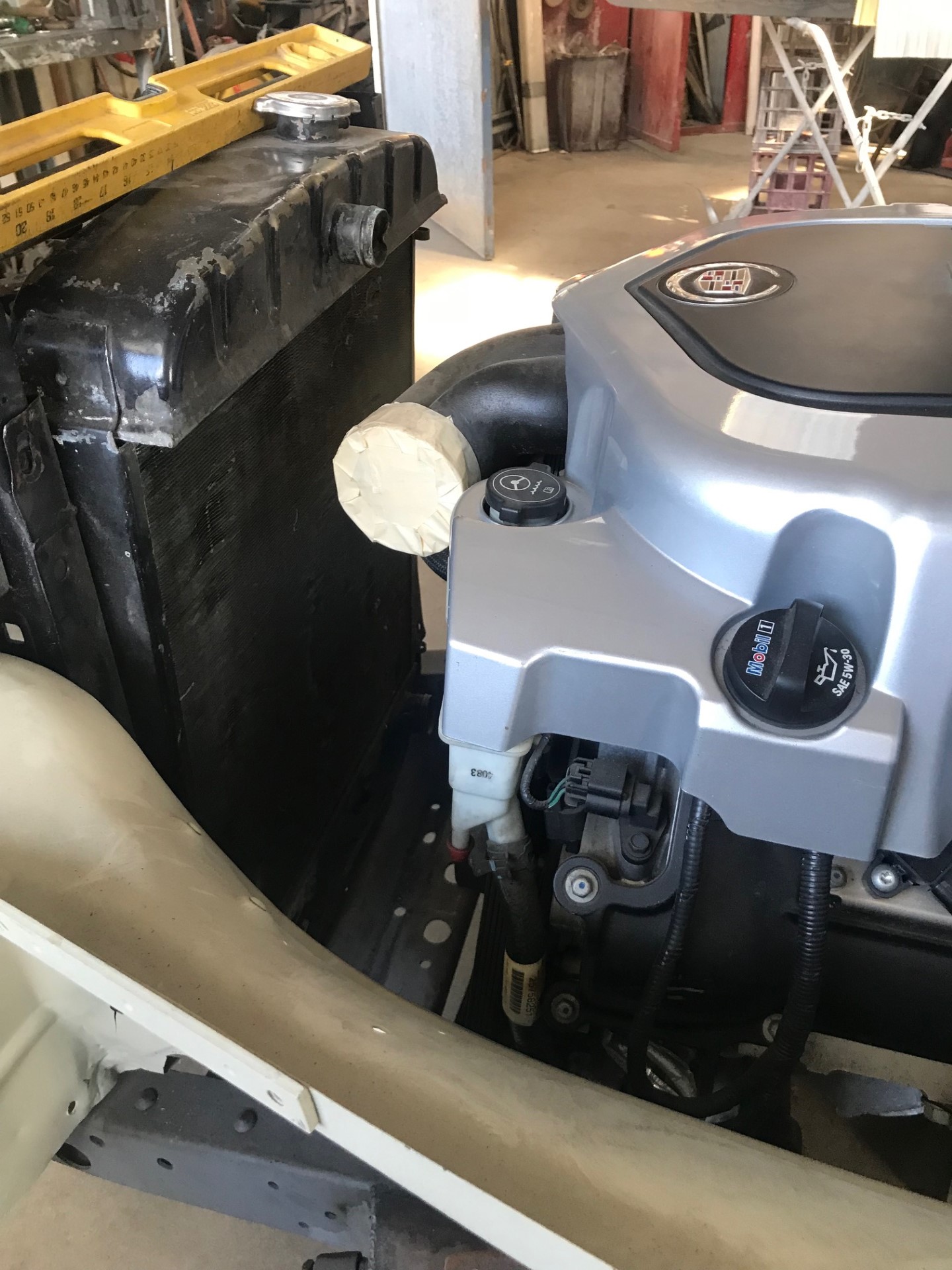

Hi Mickeytee Hope you may be able to help. I have an LC3 engine and trans that is basically new, and I'm in Melbourne Australia and we have NO info on these Caddy engines other than what I can find on the internet and bits of info I follow on Northstar on Facebook. I am putting this engine in a 53 Chev Pickup that we are hotrodding. I didnt want to use a LS as everyone else does but I'm finding a few problems. I have to get a complete new loom end ECM made for it and also a new control for the trans. Are you aware of any one there in the US that makes/has made stand alone engine looms for the LC3 please??? I also have a private email that you could reply to orourkekevin53@gmail.com Really hope that you can find the time to drop me a reply , even if you cant help with any info or advice on these - we have nothing here in Melbourne, Victoria , Australia - we never had Cadillacs...even.....

That looks like a great conversjon and will be different than an ls for sure. Looks like you bave a lot of the wiring and all not sure what all you might need. I sent you a privatemessave to help
