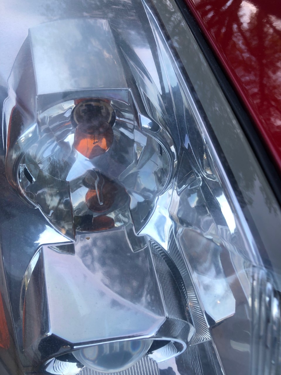

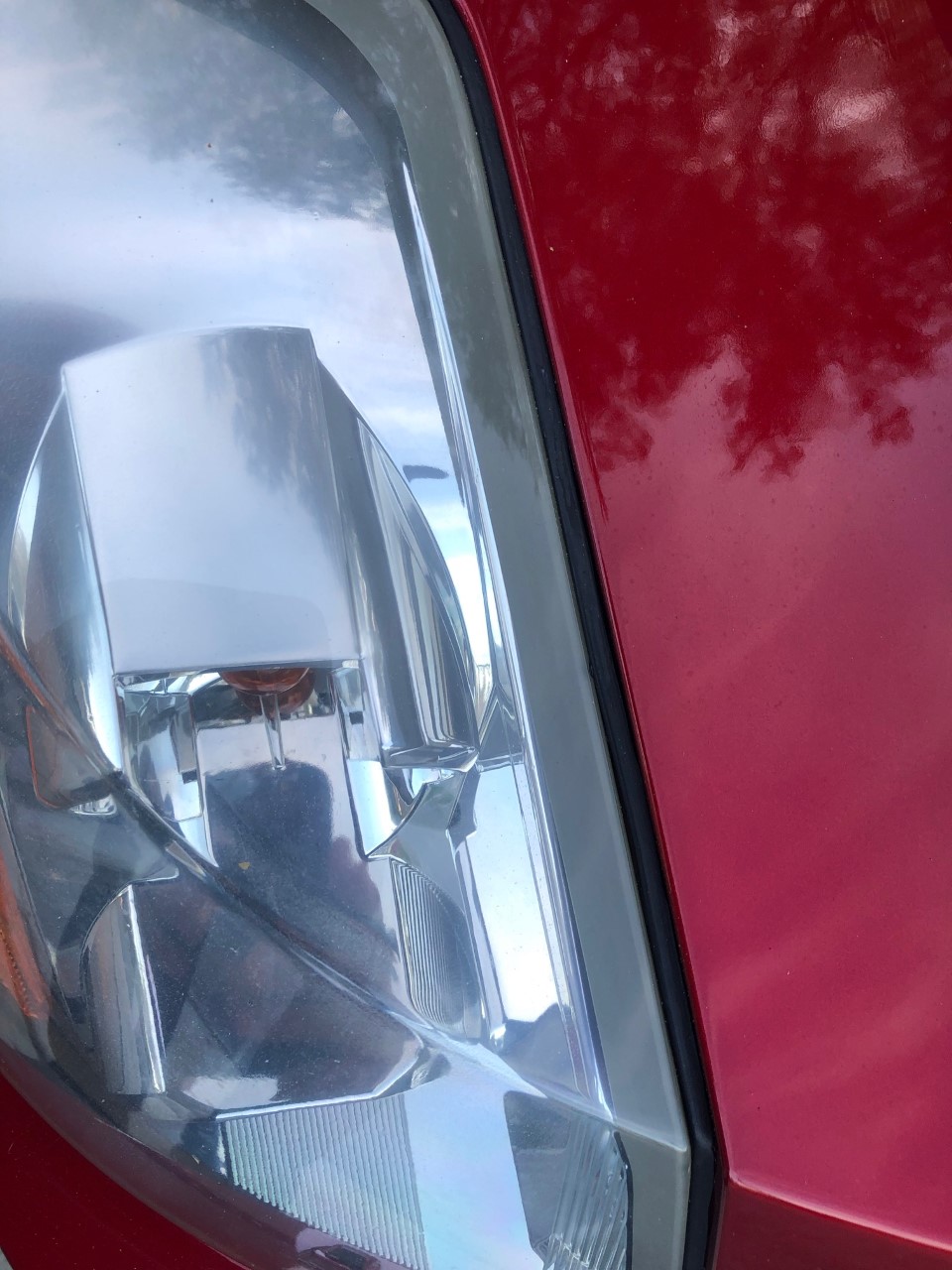

I had the melted amber lights on my 2004 XLR and just took the assembly and carefully heated the sealed unit with a common hairdryer until I could get it apart. Then I just cut-out the melted lens and use amber bulbs. Works great so far.
Took it to a garage who took a heat gun/hairdryer and heated up each headlight assembly until they would come apart.
Then he cut the melted lense away so it did not attach to the light.
Put in new amber lightbulbs.
Glued the assembly back together.
Ill send you pics later today.
Bobby
