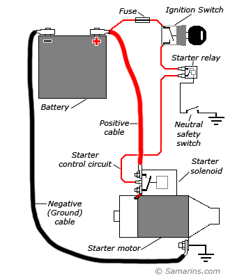

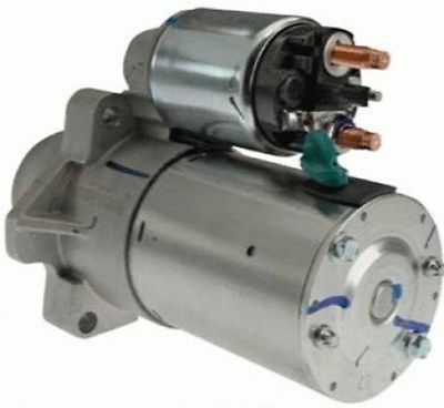

Starter problem
Melificient.
Most of the time the battery is the problem, because not using too many time the car and with no tender connected to the battery to keep it full charge.
If your dealer say it was the starter after he scanned your XLR he was meaning perhaps that the solenoids switch has fails, that item is part of the starter.
The solenoid interior element could be defective and it could stop the battery current to go at the starter when you press on the starter button.
Electrical problems on a old sofisticat system such as an XLR, could be of many components of the car.
Enclosed are some images that explains how usely the system is working and a XLR starter with its solenoid switch.
Your car needs to be scanned by knowledgeable mechanics it is obvious, they are the experts and i beleive that your dealer as great chance to be one of them, call the service manager and explain him your concern and asking what he was meaning when he said the starter is the problem.
Good Luck
IAN :wave:

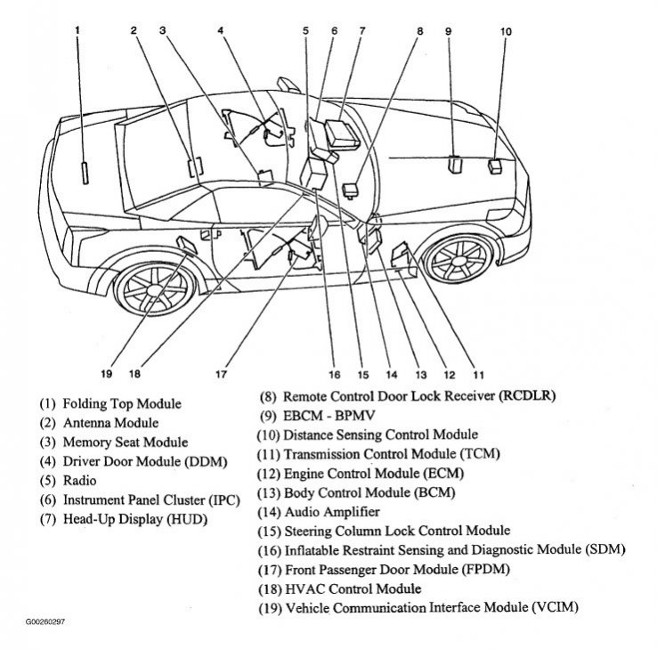

Modules do not comunicate
Melificent.
That is bad new if the thecnictian says that half of the modules do not communicate.
Did your XLR was involved in a rain storm or driven in 18 ? inches of water and got deeply soak, we know that the modules dont like water as it gets the units deadly corroded.
The BCM '' body control module'' that means for all modules, for their specific voltage needs.
Was your dealer inform you of the defective modules in order to come up with a such estimation.
A low mileage XLR 2004 whorts $15/12,000 +/- and a hi mileage $ 8/10,000 +/-, does it worth to spend that much money for the repairs....it is a hard and sadly decision to take.
The headlamps and tail lights worths almost the value of your cars.
Hoping that we are wrong.... enclosed is a drawing showing were the modules are located.
IAN :(
