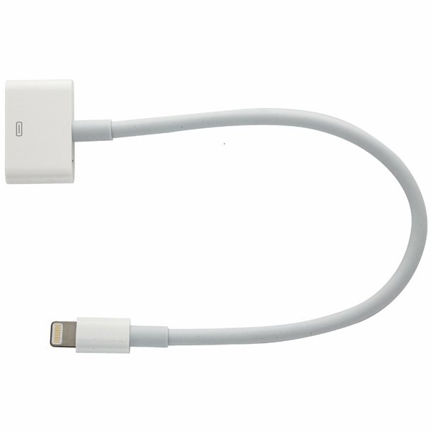

I installed a USA-SPEC PA-15 VETTE unit in my car to connect my iPod to and it works very well. It was a relatively easy install and I ran the iPod connection to the center console. I used double-side tape to secure the control box to the passenger side roll bar. You use the XM1 band on the factory radio and you can still use the steering wheel controls. However, since this was made for a Corvette there are some quirks. For instance, I was never able to reprogram the P1 thru P6 buttons on the radio like you can on a Corvette. That’s not a big deal though since those functions can be accessed more quickly on the iPod itself. The connector is made for the older iPods that use a 30-pin connection. To use a newer iPod that has the Lightning connector you will need to purchase an Apple Lightning to 30-pin Adapter. I recommend getting the one that has the 0.2 meter cable attached. These can still be found on eBay although they are relatively expensive.
(Note: The Lightning connector on this adapter is slightly larger than normal. If you have a protective case on your iPod you may need to trim the case to allow the Lightning connector to be fully inserted.)
