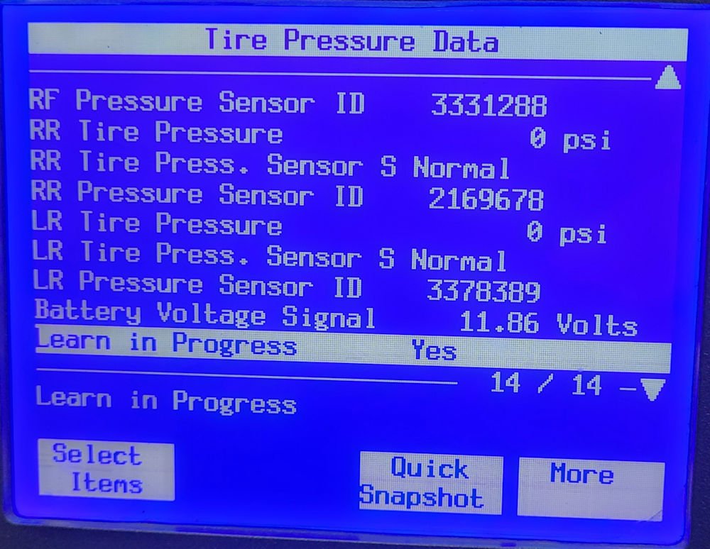

I simply cannot get into Learn Mode simply because I only get one horn chirp instead of two. What is my problem and what do I do to correct it?

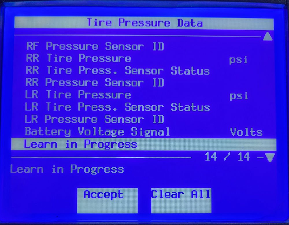

Just putting the car in accessory mode, closing the door, and pressing lock and unlock at the same time on my fob (I have tried two fobs). I only get on chip from the horn rather than two. Even though I only get one chirp I still have tried going to the left front wheel/tire and holding a magnet close to the valve stem to see if I might get a chirp from there but no luck. I have tried three different magnets in several different locations but still no job. If I try the lock/unlock with the car in the "on" position I do not get any chirps. I have got to "Tires" on my Tech 2 and if shows "learn" but there is no "lean" button to push. Well, that was probably as clear as mud.:)
That’s interesting. According to the doco, you are correct, with car in ACC, hold lock+unlock until two horn beeps. I am wondering if you need the Fob to be Fob 1?
I appreciate your prompt reply but the main fob that I tried is Fob #1 and then I tried Fob #2 so that idea is kind of out the window. I thought maybe the batteries in the sensors were dead but that would not stop the horn from chirping twice. I put new wheels on the vehicle but I don't know if the psi was registering before or not. I obviously would know more if I could get into "learn" mode which I can't.
Don (awaiting your next idea)
Ah, drat. Was afraid that was already the case. I’m hoping someone else chimes in here, but in the meantime I believe tech2 can also initiate learn mode, I’ll see if I can find the steps. I’ve not had to learn TPMS on this car yet so this will be a learning experience for me too haha
