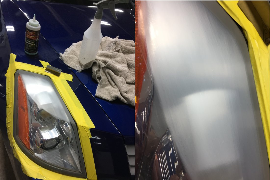

You will need a squirt bottle with water, 2000 grit sandpaper, 2 inch masking tape, a towel to wipe off the water, a buffer with a wool pad and a soft foam pad, a buffing compound and a polish.

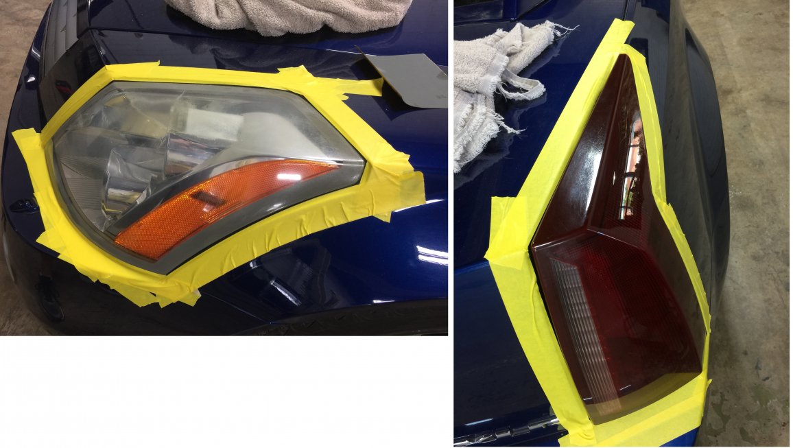

First I taped off all the lights so I do not scratch the paint with the sandpaper.
Here you can see the damage to the lights.

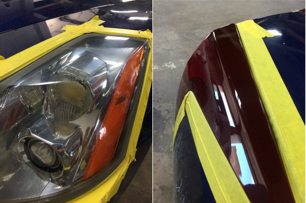

Then I wet sanded the lights with 2000 grit sandpaper, stopping and wiping the light off periodically to make sure all the damage was sanded out. Don't want to sand off more material than you have to.
The taillights seem to be a softer material than the headlights so they sand out pretty fast. Once all of them were sanded out I sprayed them off with water and wiped them and let them dry.

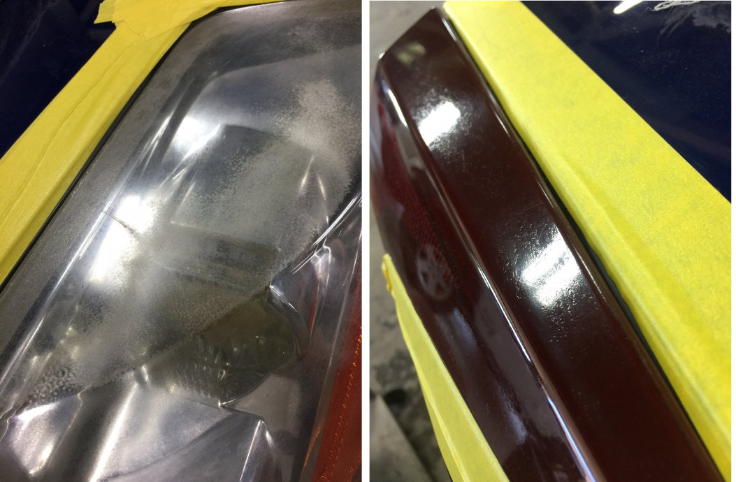

Then I proceeded to buff them at about 1000rpm with the wool pad and the buffing compound to get rid of all the sanding scratches, use plenty of compound because you don't want to melt the lenses. Next I sprayed them down to clean off all the buffing compound and make sure all the scratches were gone, they look pretty nice except they have swirl marks in them from the wool pad. So next I switched to the soft foam pad and a slower speed with the polishing paste and now they look great!

First I taped off all the lights.

Mickeytee - The pic of the now clear lens is in the first post at the bottom. It worked good on my headlights because I do not have the cracks that go all the way through the lens. I was able to sand 95% of the damage out. They are not perfect but look way better.

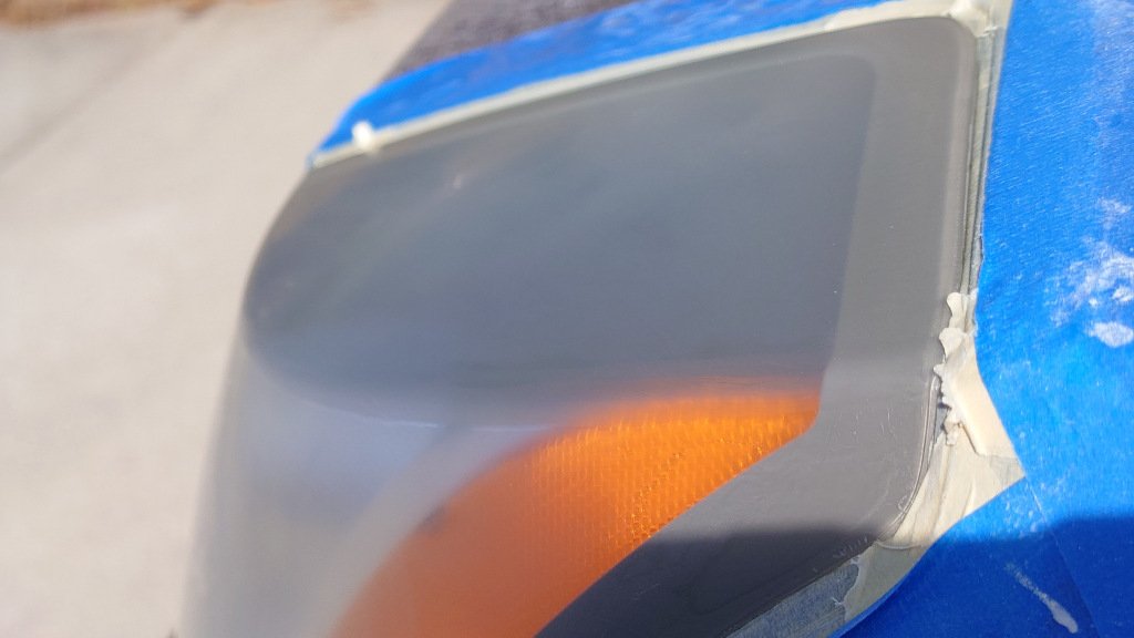

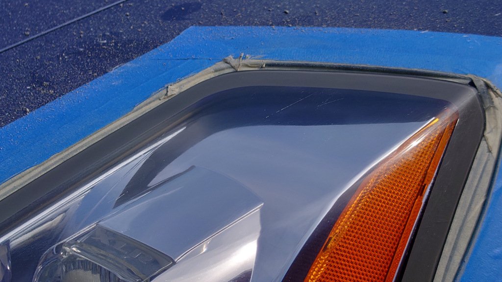

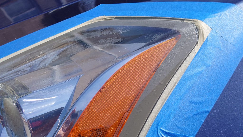

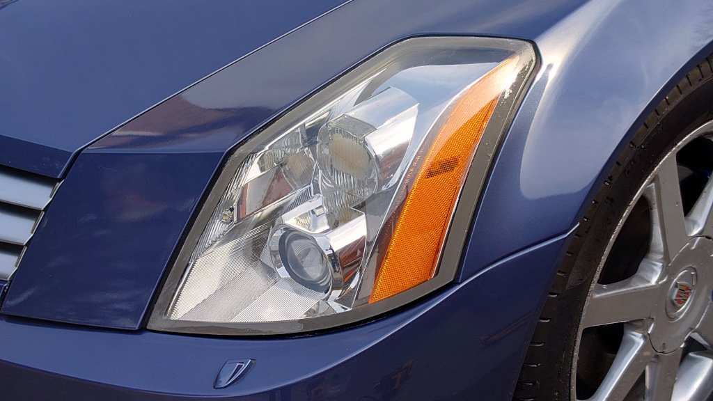

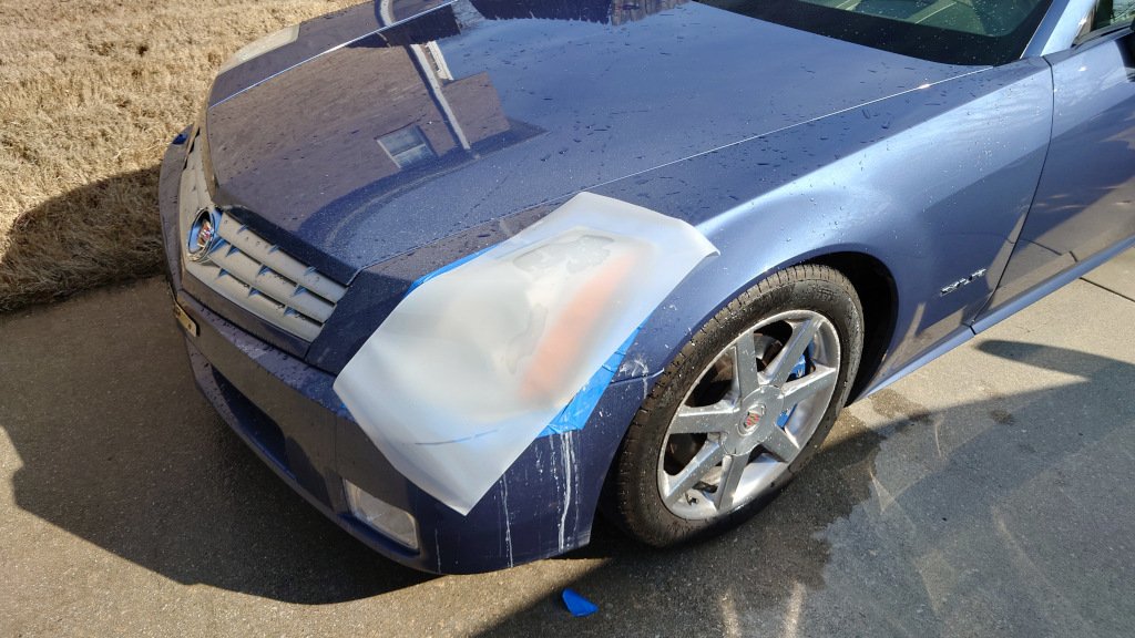

I just thought I'd my pictures and experience. This is my third time to wet sand, polish, and wrap headlights. My first time was easy, the headlights were fairly flat. The high curvature of the XLR lights makes wrapping them with UV protection film very difficult!
Sanding and polishing went well, and is easy. However, I didn't see some deeper scratches, and had to re-sand and re-polish. Unfortunately, my UV film had some creases near the edges. I'm not going to car shows with it, so I'll just live with it. Overall, they look much better than when I started.
If you need perfection, I recommend calling window tint shops to see if they have someone that can wrap headlights with paint protection film. Otherwise, you can buy it yourself from Amazon: https://a.co/d/0hrgSVx9
