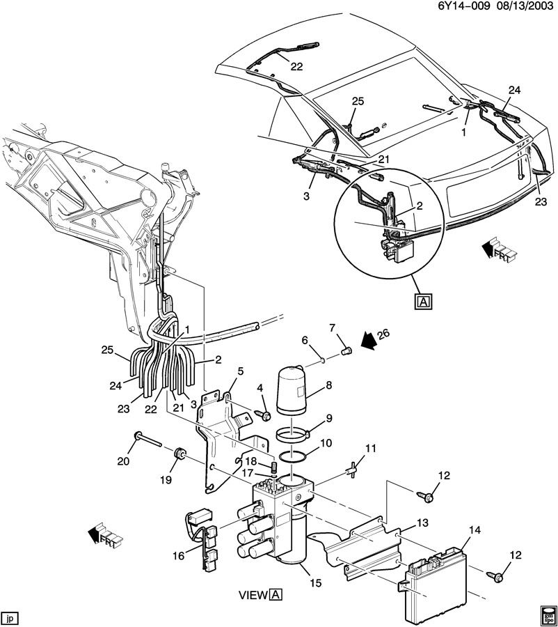

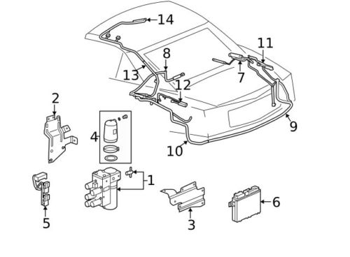

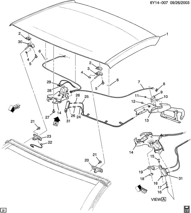

A9  s-l500008GOZZD.jpgA1  composantes pour le toit ouvrant.jpgA9    0308136Y14-009[1].jpgA3 0309266Y14-007[1].jpgA3 0309266Y14-007[1].jpg

The photos that i send you previously is showing the rear module that is the brain of the top, is the connectors covered with blue depots… yes, then what ever you try the top will not work, is your pump gets power, if no then again your chances are very low.
