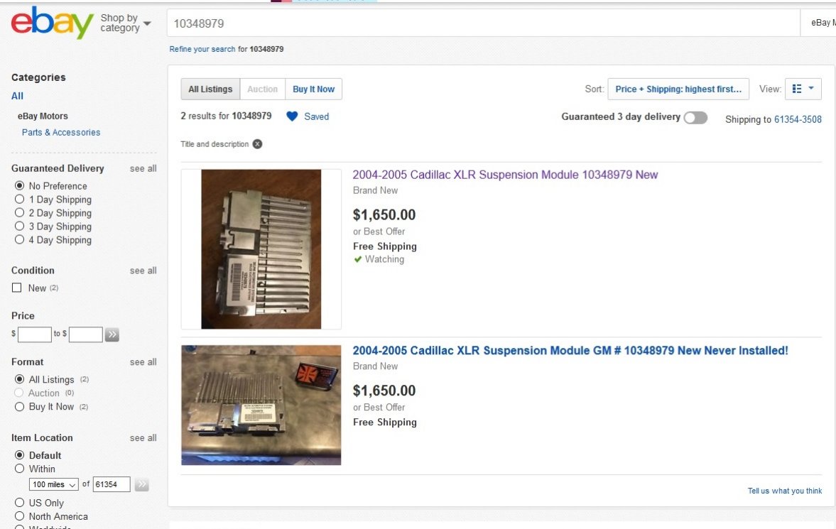

Here are 2 on eBay right now 11/10/17, I contacted both of the sellers and they did not get them recently from the dealership even though they are listed as new.
Thx guys.... this is very informative. I looked at the 2 items on ebay and noticed one photo (from EASTCONC) shows a pin advertising the company logo for the salvage yard known as ... EastCoastUsedParts.net.
You never quite know what to believe when you see and read and hear things these days but as part of my google search, I also found this YELP link for them that I think you will enjoy ... or not:
East Coast Used Parts - Auto Parts & Supplies - Reviews - Clarendon, NC - Phone Number - Yelp
