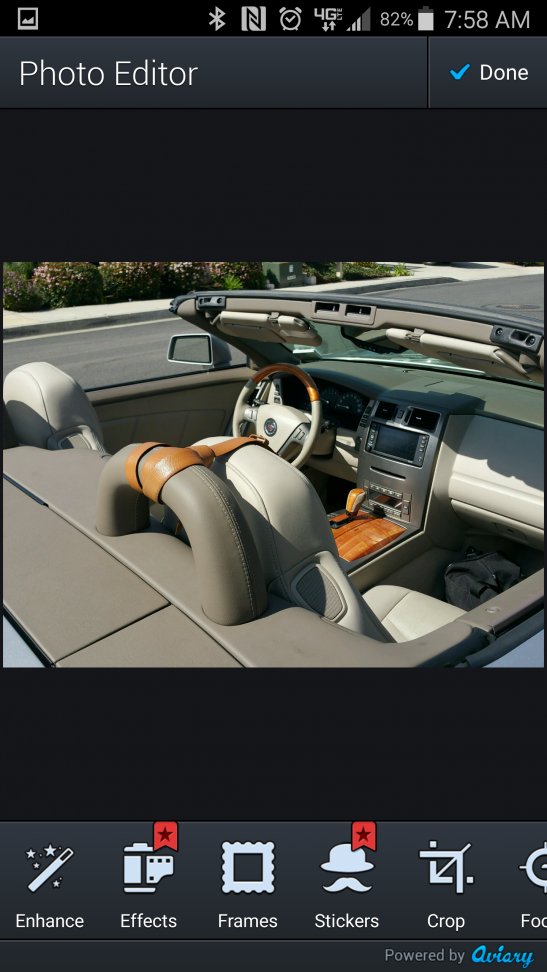

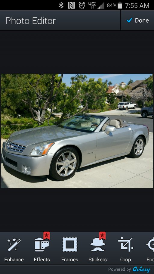

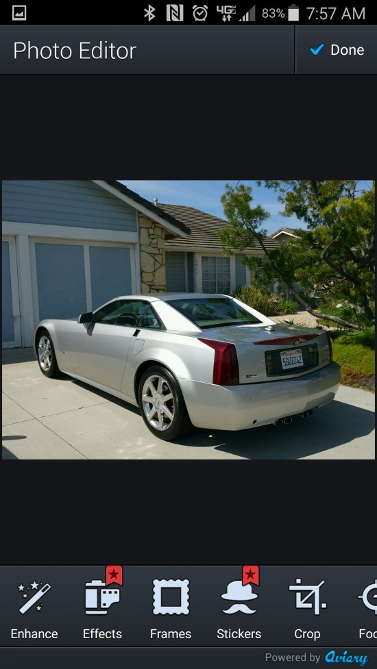

[FONT=&quot]FYI ... MY XLR IS NOW FOR SALE AT $34,933. 3 photos attached. Only
32,000 miles, one owner, very strong engine, well maintained with Mobil 1, non-smoker, mostly no passenger, no pets, never seen snow, near pristine condition except for a couple scratches here and there. Plus it has 3 brand new modules (Ride Control Module, Trunk Module and Pump). I will also include a partially used XLR tire since we once had to replace a damaged tire and decided to replace the matching pair at the same time. It was always garaged except for the first part of this year when there was a little (ahem) rain.
