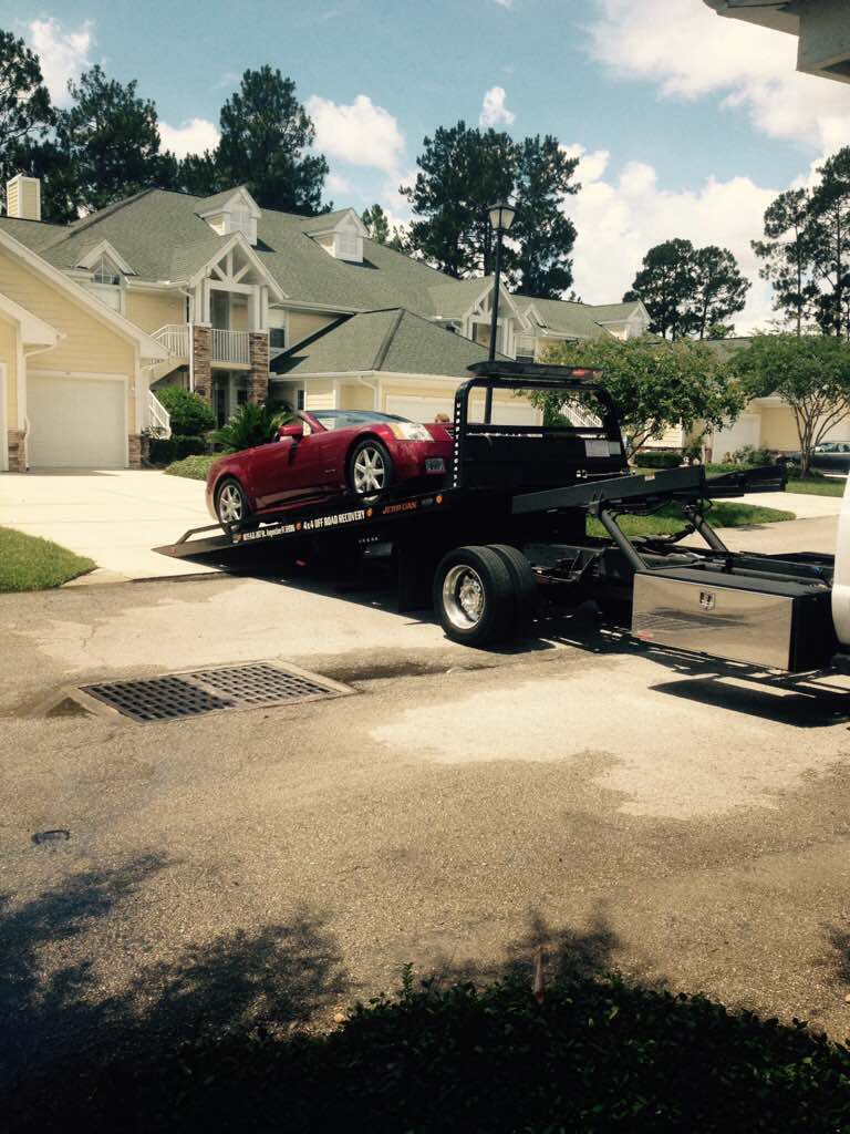

Not something one wants to see,,,,their car on a tow bed....
Is this cable breaking a common XLR problem?
It happened to mine - my understanding is it's common to XLR's & Corvettes from that time period.
The end attachments are plastic & over time it appears they are becoming brittle & breaking.
My service guy said these are common

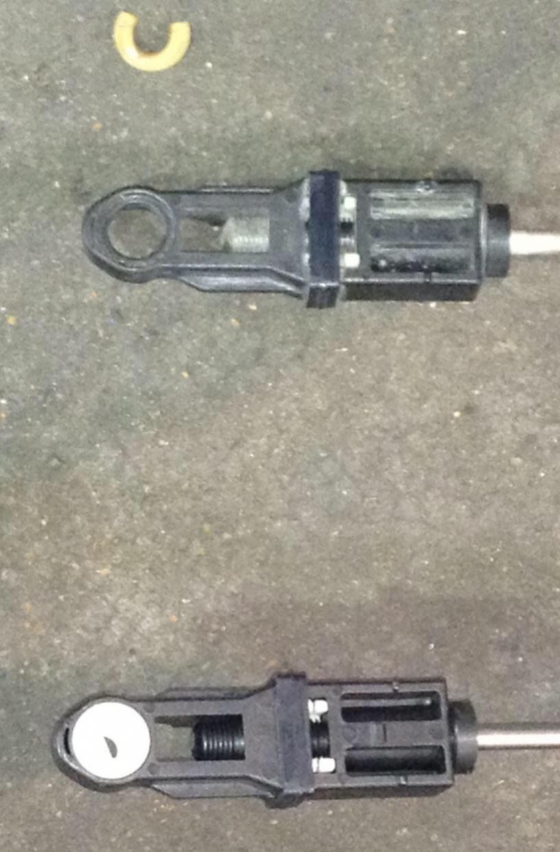

Here is a link to a thread with pictures of mine (hopefully the link will work better than the last time I posted a link): https://www.xlr-net.com/forums/cadi...anny-pictures-to-follow.html?highlight=Beauty
We bought a couple of extra cables. I think Gizmo looked into trying to get a shop to make a sturdier one but that didn't work out. Given that it's a problem with Corvettes too & there are more of them, that might lead to making of newer/better ones.
In case the link doesn't work, here's a picture of new vs. old. The yellowed half moon is all that was left of the nice new white grommet you see on the new one.
